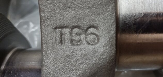

The BMS cranks are stamped to help you identify which material the crankshaft is. Here is a confirmed 4340 example via x-ray machine.
