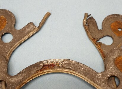

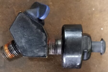

What "desensitising" a knock sensor gets you......
"Back in the day" some peeps tried many ghetto methods of "desensitising" the knock sensor, to keep it from retarding the timing. The most popular one that I heard of was 3 or 4 wraps of Teflon tape on the threads, or using a close nipple and pipe coupling to isolate it from the engine.
This is by far the most ghetto method I have seen! And the result......

That's how I bought the car with a fresh rebuilt engine with only a few miles on it....
Motor was from a "reputable, experienced" engine builder....
Submitted for your entertainment.
I have remachined and replaced basically everything....

I believe the Holley system allows changes to knock sensitivity. That could be a recipe for disaster too. This happened in 12 miles! Bought it new motor, not running. Replaced all other sensors, not knock, my bad!
O2, TPS, TEMP, MAP, all were original! TIMINATOR

The one that built the engine?
Or the one on the valve?
I wonder what the valve was originally for?
It was PACKED with rust!
