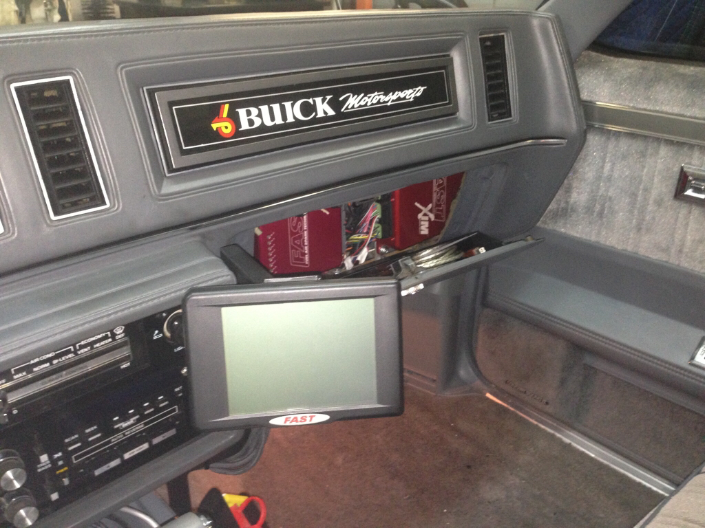

Just wondering how you guys are mounting the xfi in the glove box? I'm in the process now but don't see many mounting locations
One option might be the GNS Glove box mount:
http://www.gnsperformance.com/interior-g-body
I like the glove box idea, but mine is under the passenger side seat.
I've done 2 this year. I have pics on my facebook page. I will grab a few and post them up.
Would you mind telling me the size of the bracket you used? And is that the replacement glove box gns sells
Yes it is the replacement GNS and I used piece of aluminum L bracket from Home Depot I think it's an inch and a half I just rounded the corners
