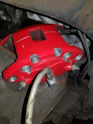

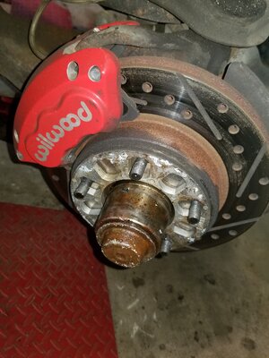

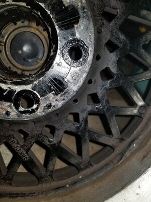

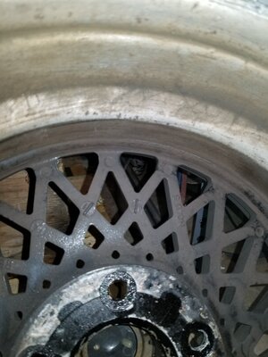

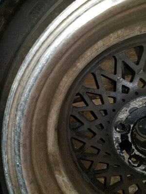

1st does anyone know what totors theae are?

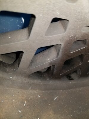

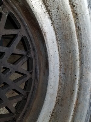

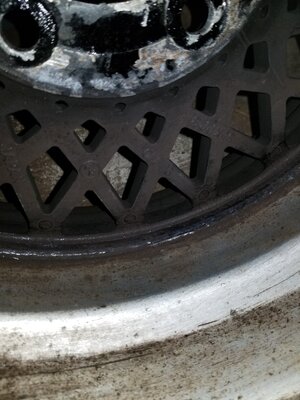

2nd Dows anyone know anything obout this type wheel. It seems to be or have a welded center

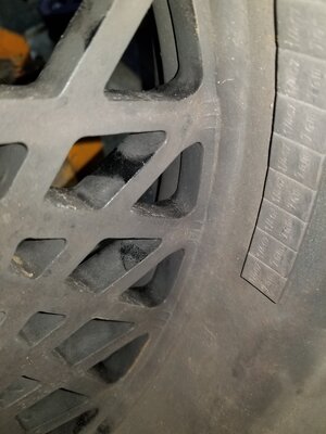

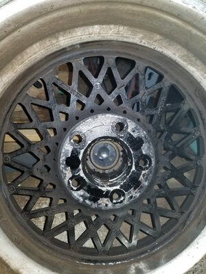

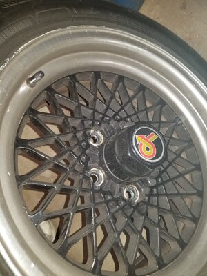

the rim is an 85-87 GTA (non dimpled spoke ends ) rim its 16x8 and came in front and rear offsets for use on the trans am , they were two piece rims with center welded to the drum ,,later dimpled GTAs were one piece. yours is a rear and has more backspace than the front version and would need a 1" spacer to use on the rear of a gbody ..most Gbody users install four front offset rims or put the rear gta rim on the front with a 3/16-1/4 spacer so it clears the steering tie rod end
the rotor looks like a raybestos drilled and slotted stock replacement

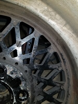

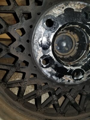

Found writing on inside.
Japan. Rear only. HOLO 5. 8JJX16. OFF 16. HH.
This is all the writing on the inside

yes its a gta 16x 8 rear for trans am usage which had different front and rear offsets to work on that F-Body
, yes they were made in japan (theres a JWC logo on face )
i didnt ask for more pics i saw rear in your first set .. why all the pics?
To show they are welded together. I hate spacers but have not choice without replacing the wheel. I just inclided the pictures so someone could tell me about them. Being made in japan confused me.. sorry
