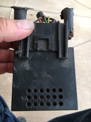

I can't remember if it was you mikestertwo but I had asked how to test them ... on the thread NOKA72 started that was lost .. so here are pics of the wires going to one ... appreciate if anyone knows which ones I need for hot and ground .. thx

The Orange wire is hot all the time, The pink with the black stripe is switched power, the black wire is ground.
