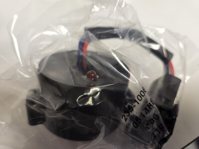

Anyone run the Walker cap 235-1006, it sells for $65 on Rockauto and weird pricing from $45 to $450 online?????
Even the photos are with an LED on the cap and without.
The one on Rock Auto, the one with the LED light is a cam position SENSOR, not a cam sensor CAP.
Big, big difference.
Casper's sells a cam sensor CAP with and LED light, bit they are known to be troublesome.
I'm not sure what the cap is then, curious?
I assumed the black top was the cam sensor cap vs the shaft body.
This Walker Cam Sensor looks like the Caspers Cam sensor, what are the odds the Walker also has an LED too?
