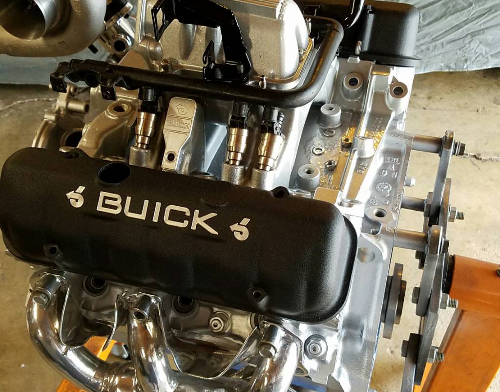

Hey everyone. Having a valve cover fitment issue I was hoping someone else has come across and may know a trick to resolve it. I have an 87 GN, stroke build with champion irons, and GN1 covers to clear the roller rockers. I've removed the heat shield on the air box, all brand new motor mounts and body mount bushings, and I still can't get the cover to line up withthe holeholes on the passenger side. Any suggestions?

Those covers are very tight. Maybe the body isnt on the frame straight making them not fit.
I just find it disappointing that all the effort to change the bushings, and it looks as if there's virtually no additional clearance.
those clam shell style low profile are from TA performance but fit all production style heads (stock irons, champion iron or aluminum or TA performance )
the ones you have you call GN1 are not champion but TA performance . try the TA low profile or the Champion valvecovers

Champions.... the rear passenger side mirror bottom bolt is a pain in the ass...but better than the Kenne Bell style he has.
Those are TA heads? will they work with champion irons?

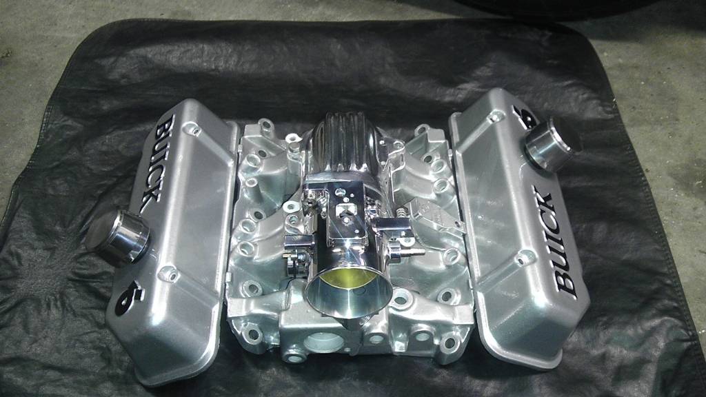

I have a set of Champion valve covers to sell just like the ones in jasjams photo. Great condition. I actually just bought a set of the tall TA covers like yours a month ago because I prefer those. My car has no AC box.

Nice you powder coat valves and Intake?
No, the guy that did that stuff landed a great job and doesn't coat anymore. A buddy dropped the valve cover on a rough concrete floor and it didn't hurt it one bit.
