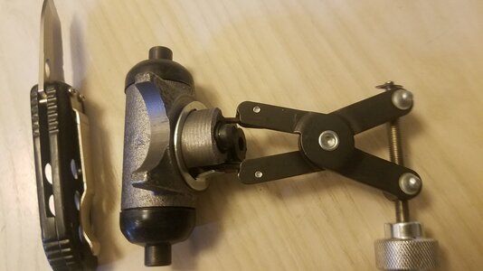

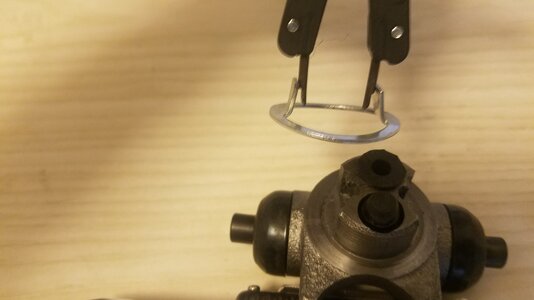

It also helps out alot if you have this Brake Retainer Tool
I could never get that tool to work for me!
Had to come up with some other ingenious way of McGuyvering it
