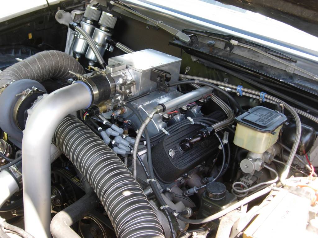

Here's a pic of my buddy's catch can set-up for one of his Stage cars. He's got catch cans for his valve covers, but does have ac delete.
