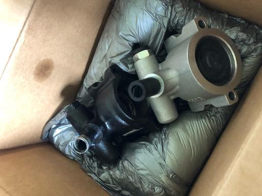

I recently installed a hydratech braking hydro boost. Much to my dismay I have a bad whine in the ps pump. Just had a ‘new’ cardone ps sent off for rebuild. I hope this works! It is pretty though.

While we are in the subject of pump has anyone overhauled their own? Have an idea where to get a kit or seals or whatever is in there. I bought another pump and didn't really want to drop $200 plus shipping on having it rebuilt. Can't be too awful much in there.
