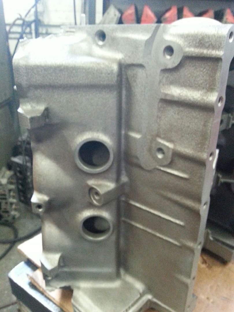

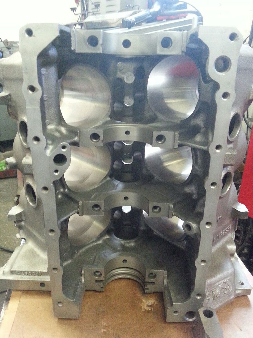

LIVE4RDO

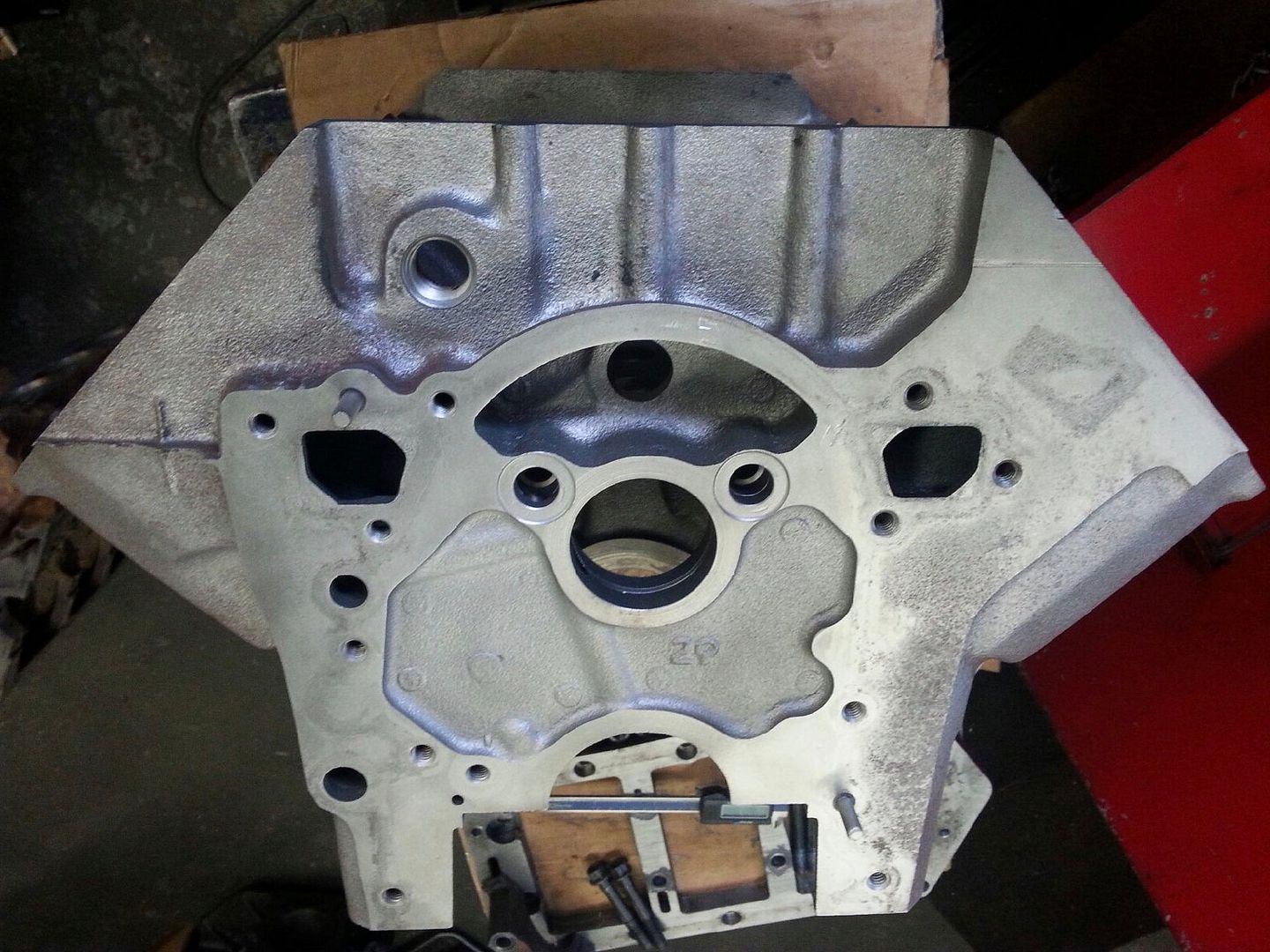

Might as well go stroker, right? Why not!
Some quick shots from machine shop
That's all I have for now. As you all know, machine shops don't do anything quick. So it will be awhile. But does not mean that I can just sit around and do nothing, right?

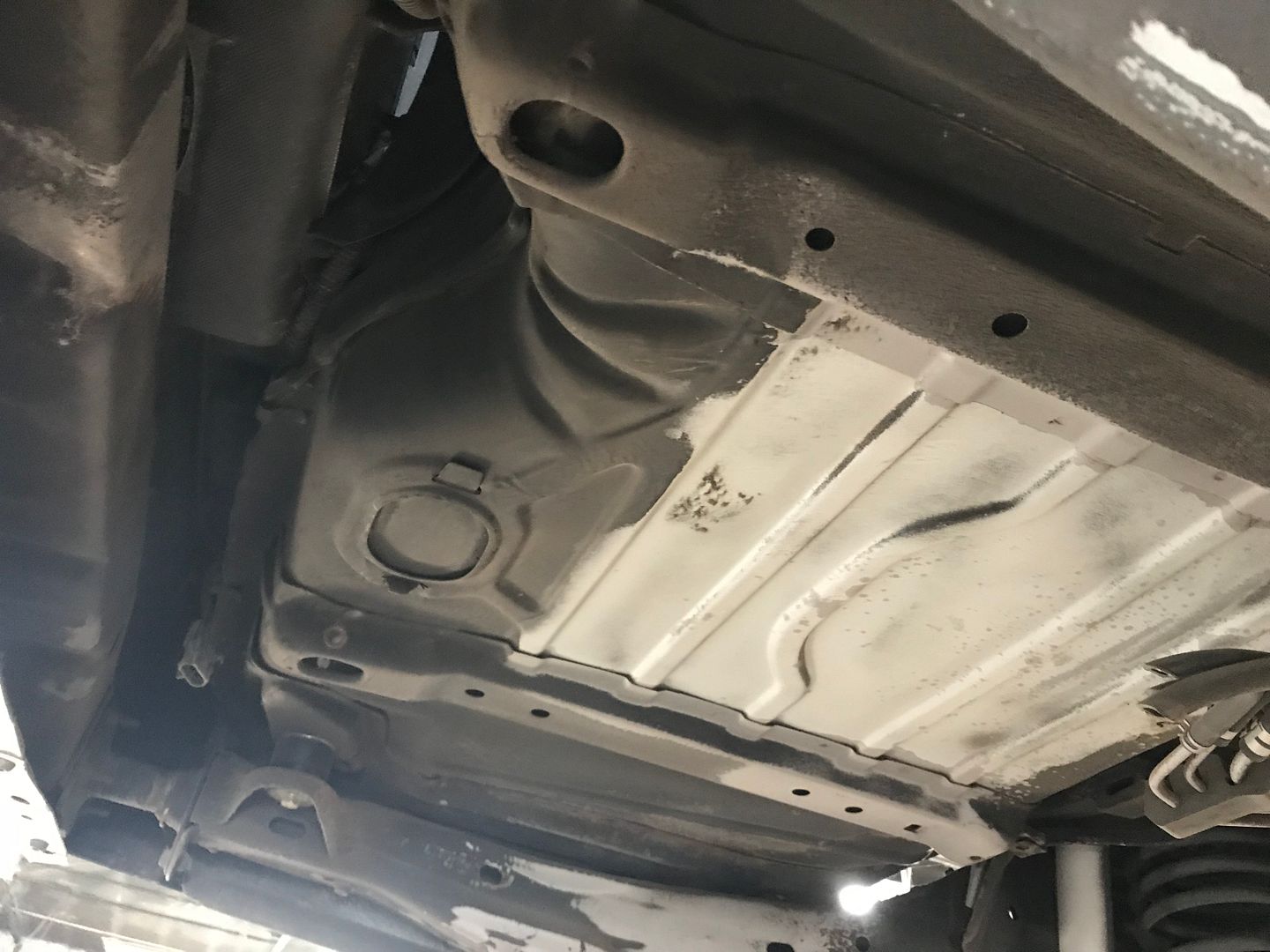

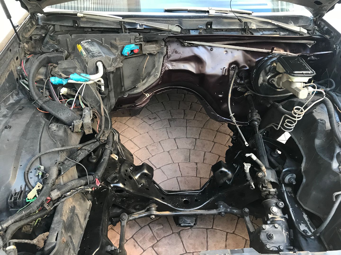

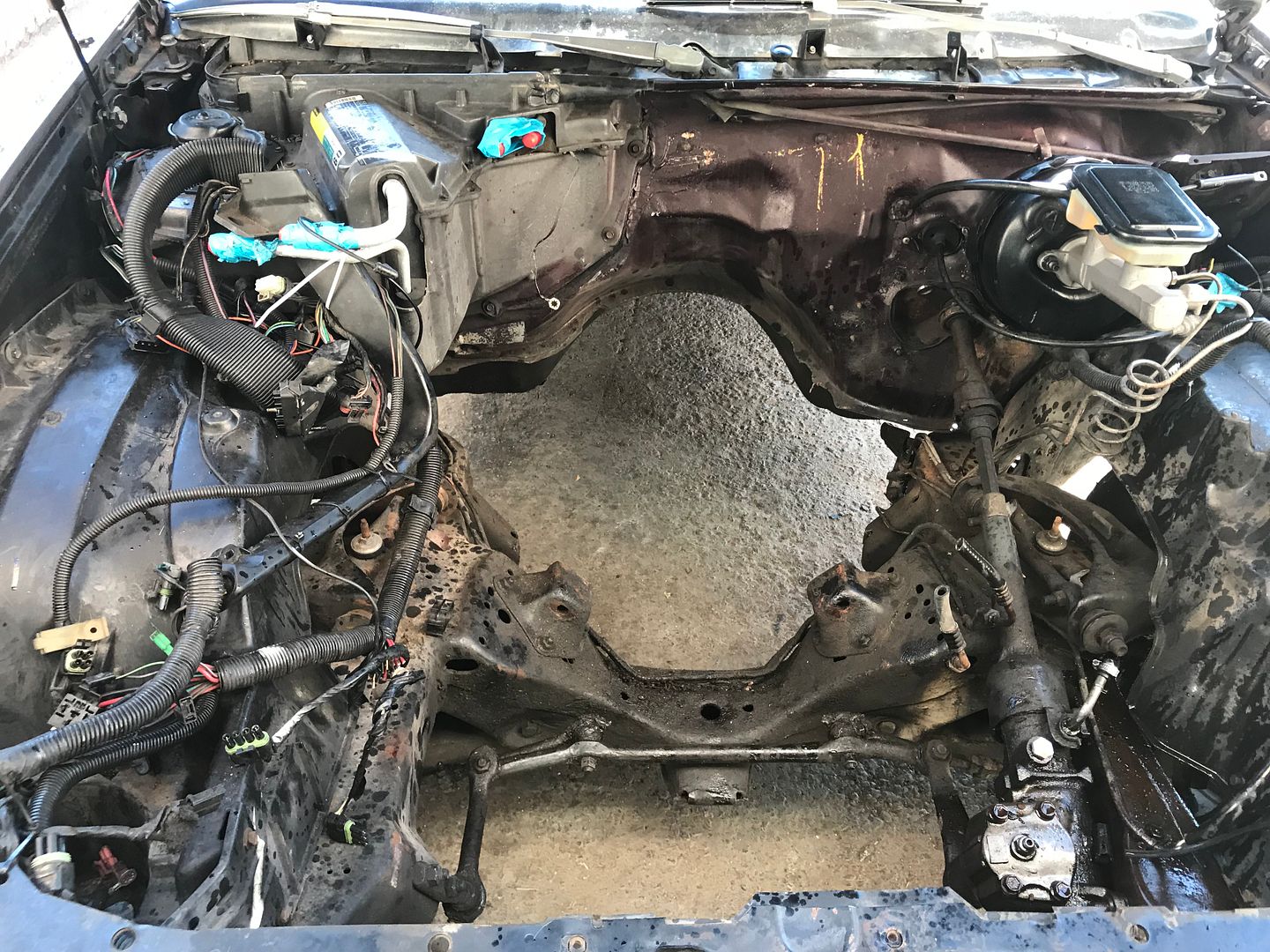

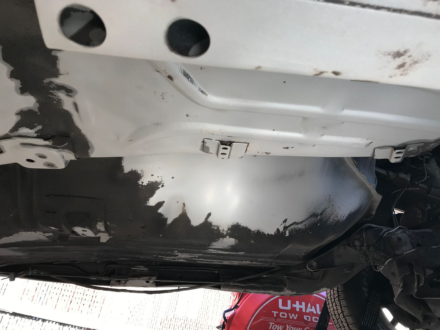

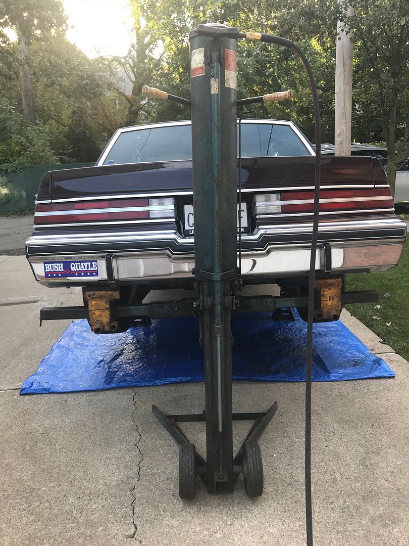

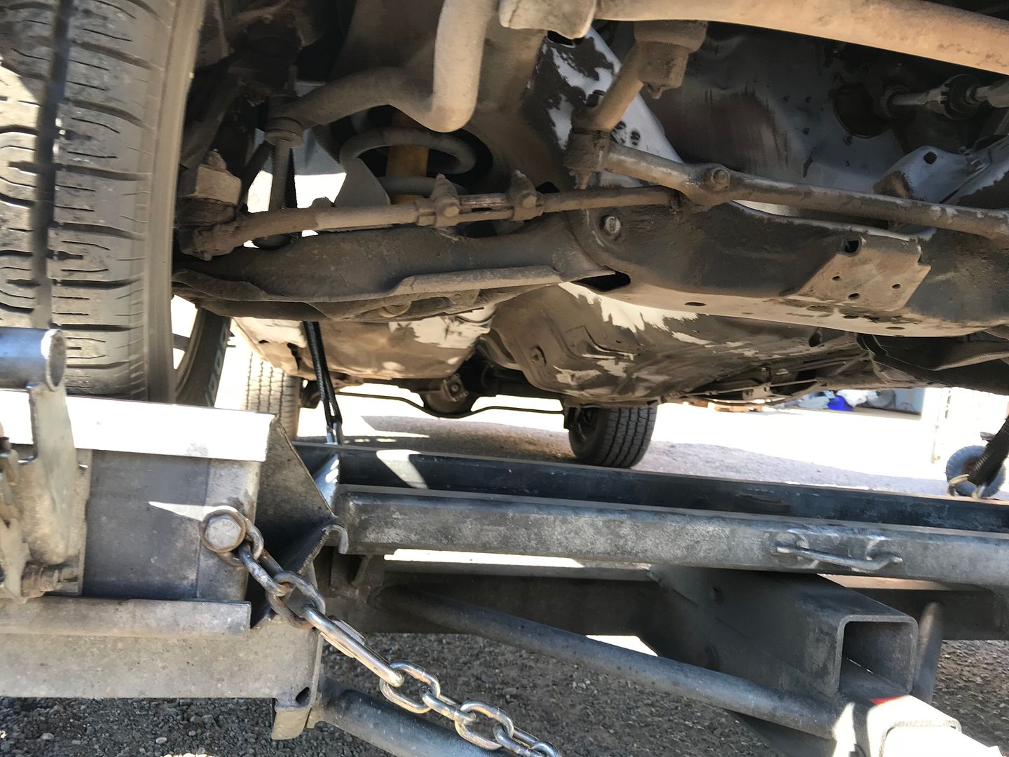

Decide to get the undercarriage cleaned up. Did the best I could without taking the body off the chassis...

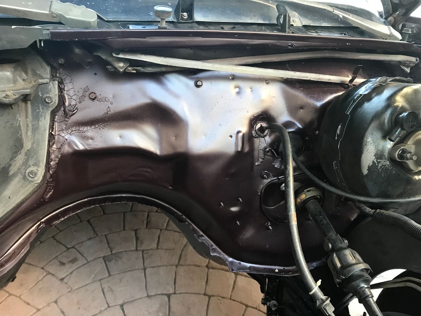

Nasty firewall before
Empty and dirty engine bay
On my way to sandblaster
And the best they could do...
Some of the undercoating just wouldn't come off.

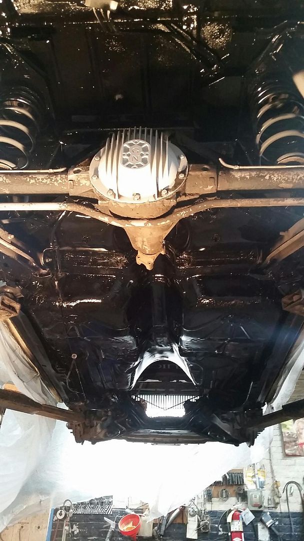

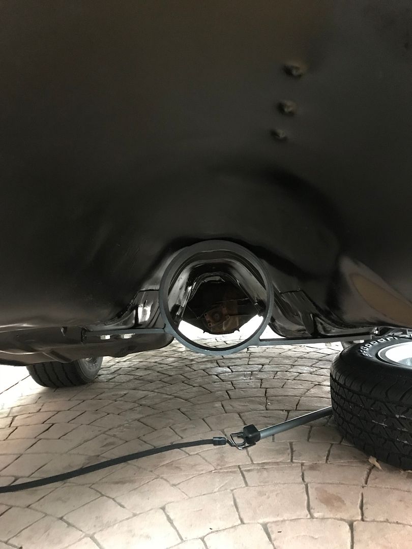

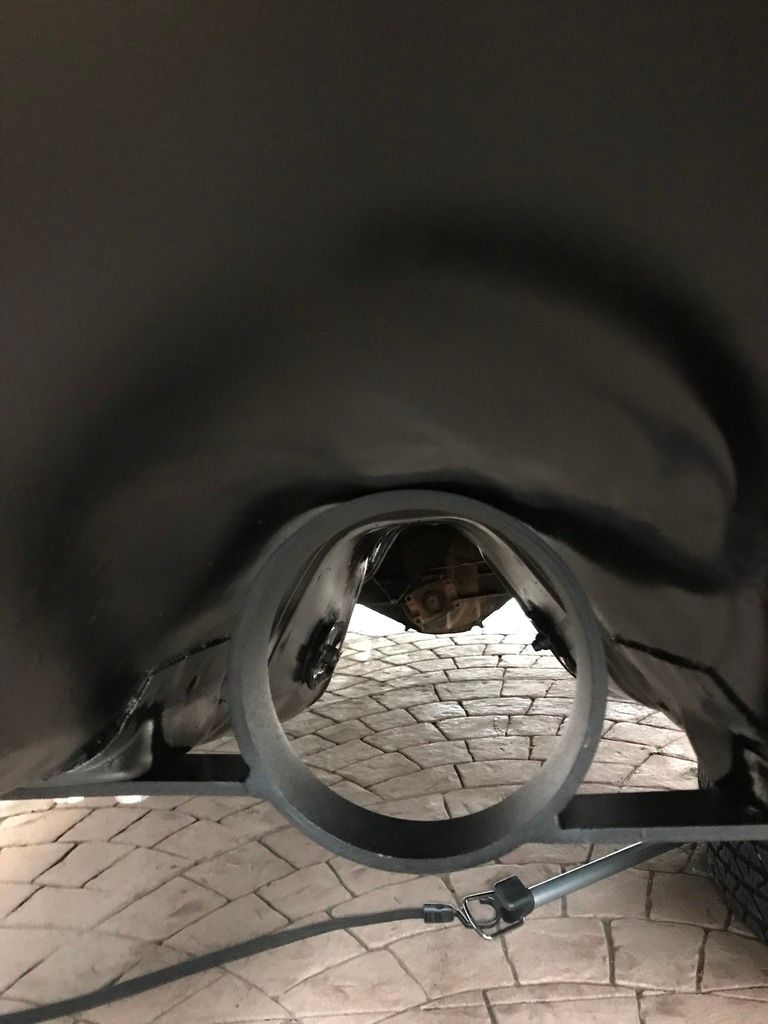

LIVE4RDO

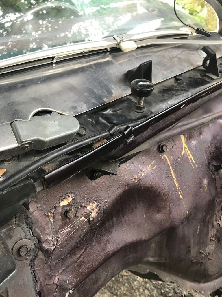

Body shop did the rest
Nice firewall after:

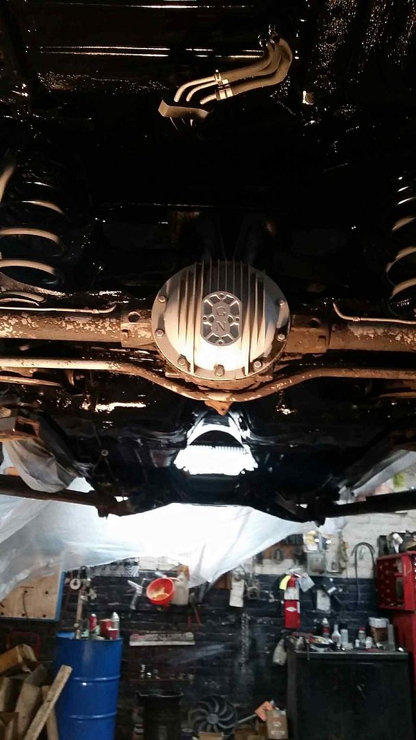

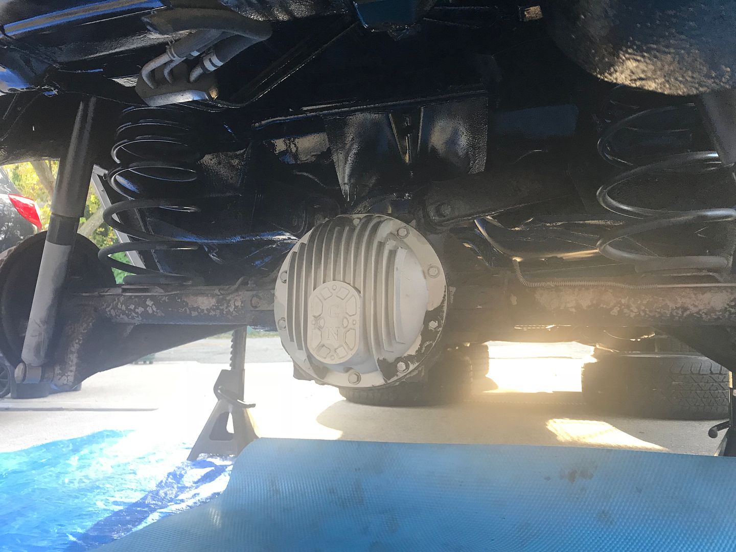

Undercarriage, rust encapsulator and few coats of Eastwood chassis black

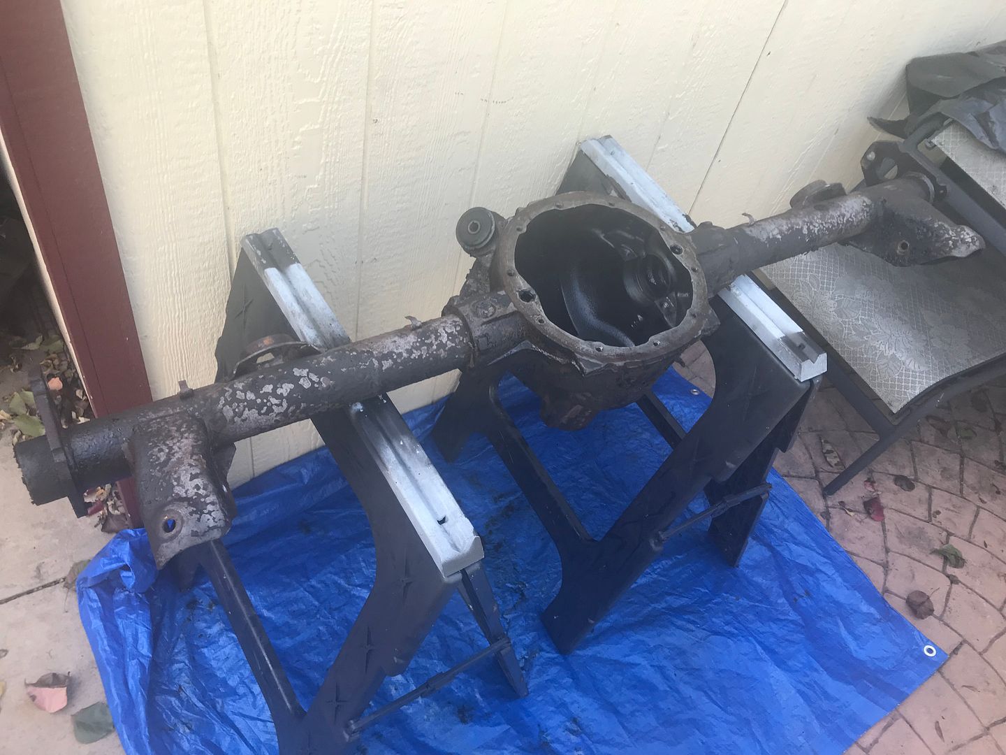

Rear end was not painted on purpose.
Why?
Because I just can't leave things alone!

Cylinders needed to be bored out, crank cut. Obviously the whole thing needed major cleaning. Made sense go stroker route and get a "little" more out of it.
A little bit is s better than nada....... ;) some time you want the whole enchilada...

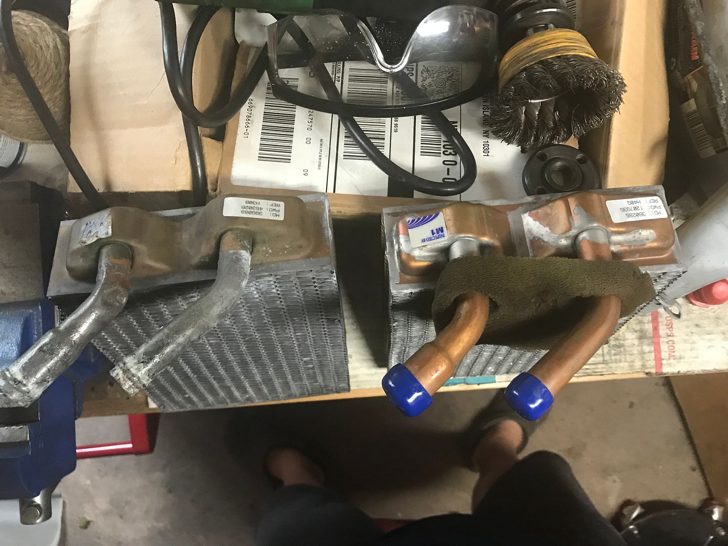

Very small updates, getting cold out here so my work is slowing down

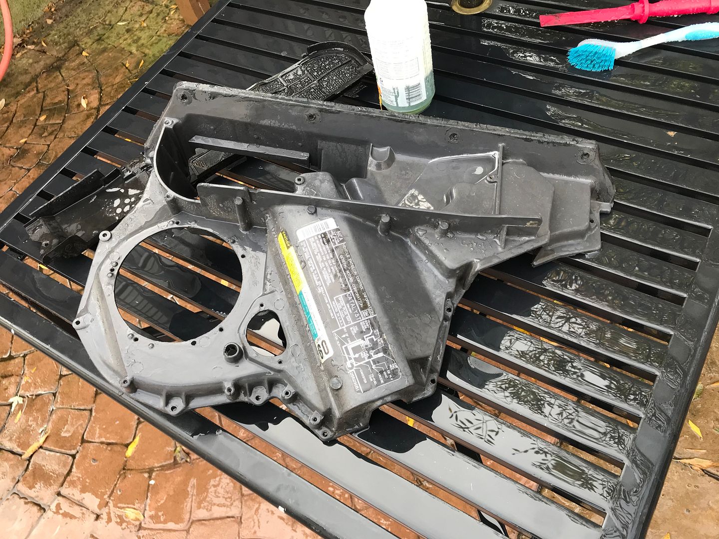

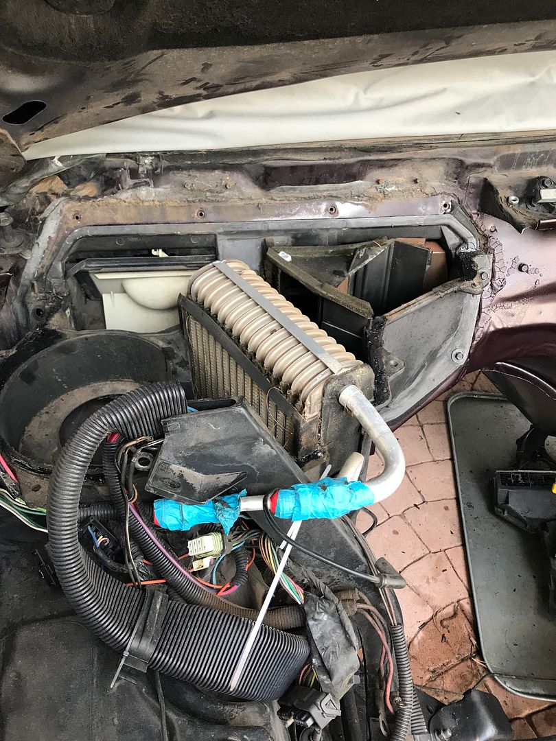

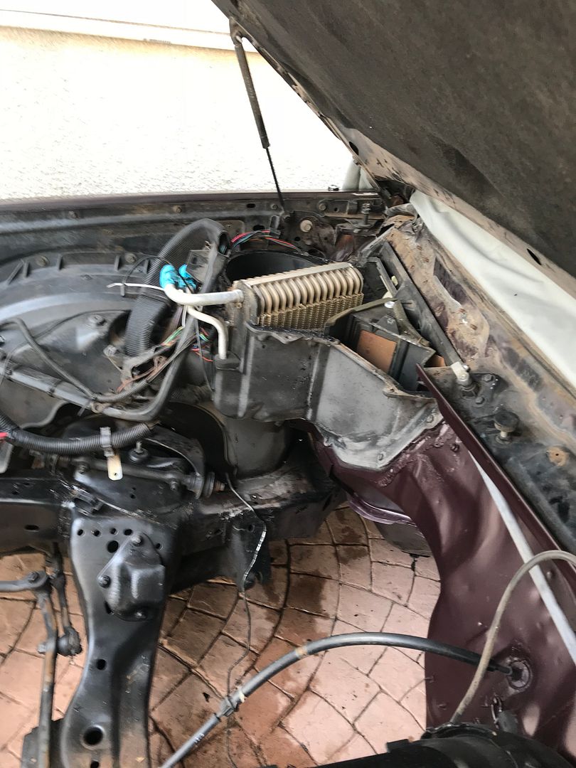

METCO safety loop

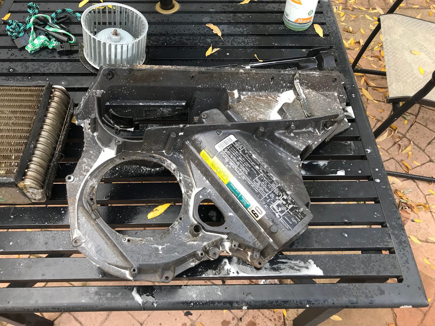

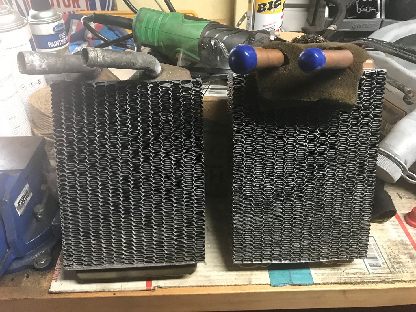

Replacing my heater core and cleaning everything around it
Yup! Scored copper heater core on fleabay
As soon as the weather breaks for butyl tape to stick, I can put it all back together
