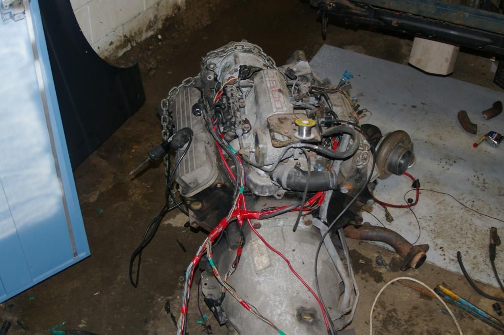

wiring time my favorite night time quiet activity.thats the whole engine part done including extra wires for gauges, meth injection injector,knock ears ,wideband,boost control etc.even added a 2nd IAT plug in another location just incase i swap to measuring air pre throttlebody.now i just need to get it on the car and fit the grommet where needed and shorten all the ecu end to suit ecu placement and hook up a shit ton of relays LOL
