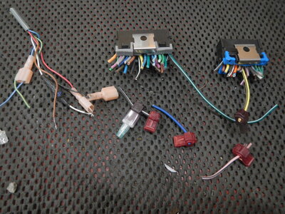

I was checking my sensor wires a few weeks agao and noticed some issues so I decided to fix them all. Sadly I did not realize until i got into this that a couple of issues that badly needed addressing. I should ahve done this a long time ago.
For one, my crank sensor connector was broken, the clip was broken off. I spliced in a new Caspers replacement connector.
FYI... Most wires are 18 guage but there was one 16 guage on the IAC from what I remember.
I also had this from my TPS sensor... I had to remove the previously installed heat dhrink to find this... :oops:
This on my IAC connector:
Some connectors I completely reqired and some I use what was still good. Here is the final prodcut with new looms:

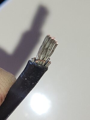

you are exactly right... I did the Casper ground wire stretcher kit about a month ago and found this sensor ground wire
and that has led me to check every wire in this 'time of confinement'... gotta do somehting, so I might as well make the best use of my time.

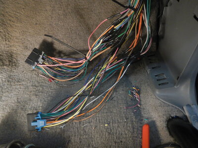

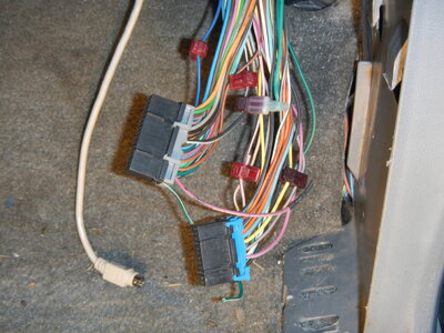

Not as bad as that , but this was the garbage in my ECM harness . Casper's connector with pigtails worked great !
