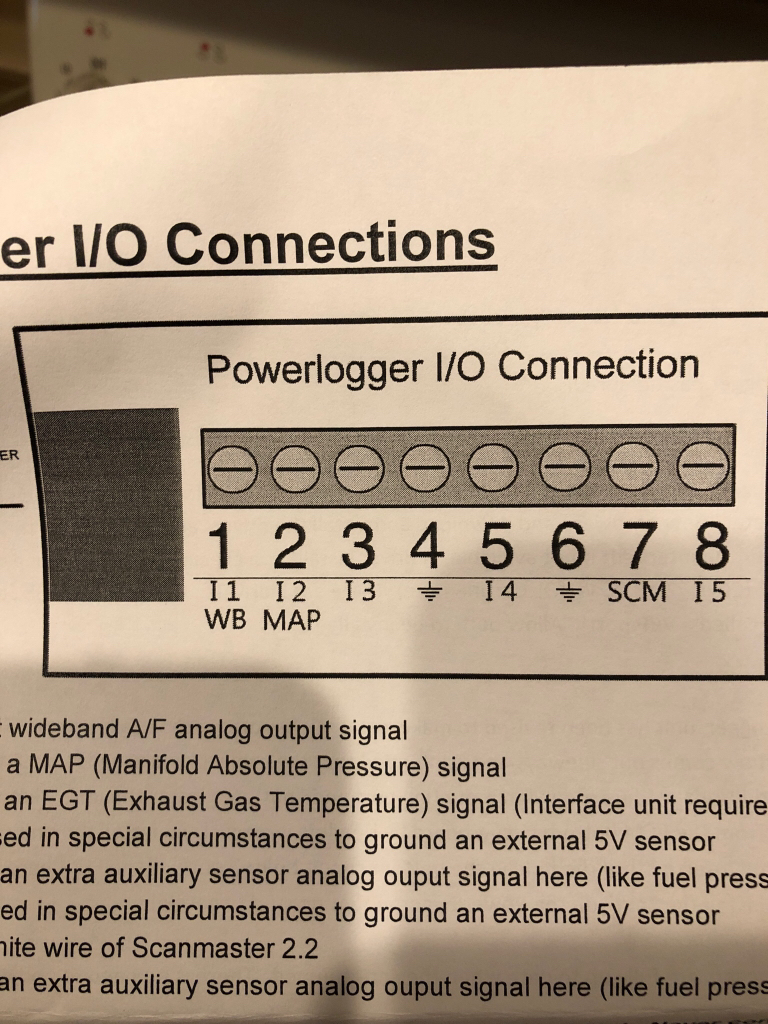

I Just bought a scanmaster G and want it to display the AFR Reading from the powerlogger, I have the comm wire hooked to the orange wire at the aldl and I only get the normal buick datastream. Does the scanmaster g somehow hook to the powerlogger directly to read data instead of the aldl? I do have the scanmaster g selected in the powerlogger and the afr checked in box.
you have to move the data wire from the aldl to the powerlogger scanmaster port on the aux block
To get the data to work correctly you may have to remove a component on the circuit board of the Powerlogger as well.
