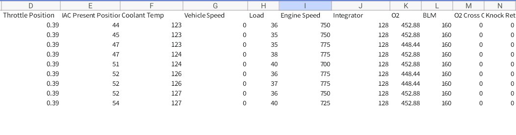

I have attached scan at idle. BLM seems to be high on idle scan?

What is the next step with such high BLM?

The BLM’s are above the normal correction range. I’d suspect a vacuum leak or a leak in the intake system after the MAF Sensor. Bad fuel pump, clogged fuel filter possibly. Are you throwing any codes? Bad O2 sensor maybe.

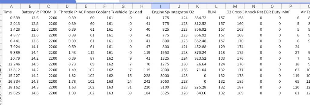

Here is an updated scan. This is a brief idle at part at a stop light and then a medium press on the gas it sputters and misses bad after the 7mph mark and it looks like the O2 levels drop to 0?
Sent from my SM-N950U using Tapatalk
Looks to me as tho the MAF readings are whacked...MAF Dropout.
The O2 readings do the same.
The IAC is opening.
