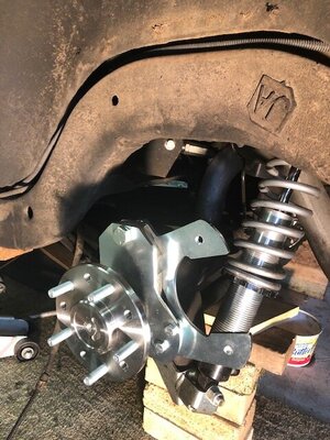

I'm in the process of installing Right stuff kit AFXRD78Z summit racing
Still need to do the other side and hookup the lines and E Brake

conn84gn, do you have to pull the axles to install that kit???.....just curious, looked at that kit some time ago
Yes had to pull the axles that was simple part
Removing the old dust plate and rear brake piston was PITA
The install was easy and decided to install new Mosser axles and new bearing and seals
Still need to do the E Brake but want to do it on a lift
Road tested and very happy
What I like about this kit was it holds the axle in so no C Clip eliminator

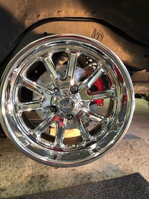

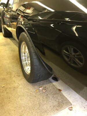

This Kit also moves the spacing out 1/8" both sides which was great since I'm now running 275/40/17 rear
I believe they are 10.1" wide so I have 3/8" clearance by the frame no rub so far
This was with stock drums and Nitto 275/50/15
Need to take pictures for the 275/40/17 M&H drags
