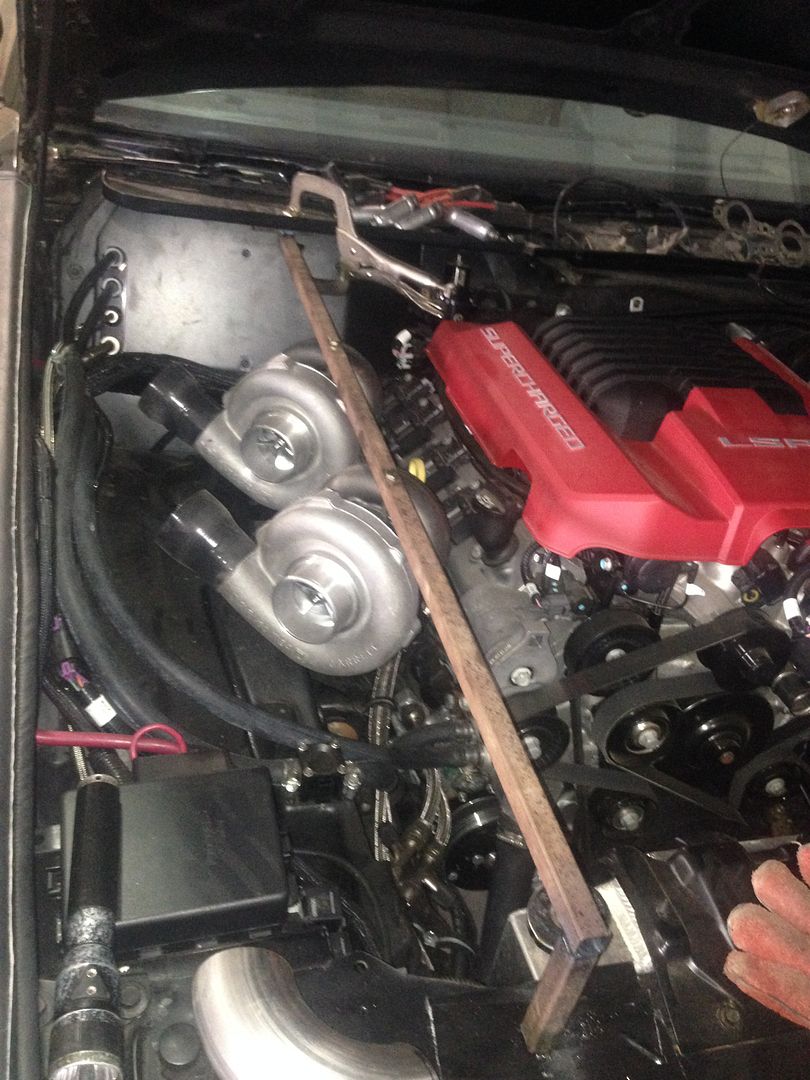

Finally figured out the turbo locations and worked out the plumbing. The ZL1 top looks much better on the LSA than the CTS-V top. Coming together!
