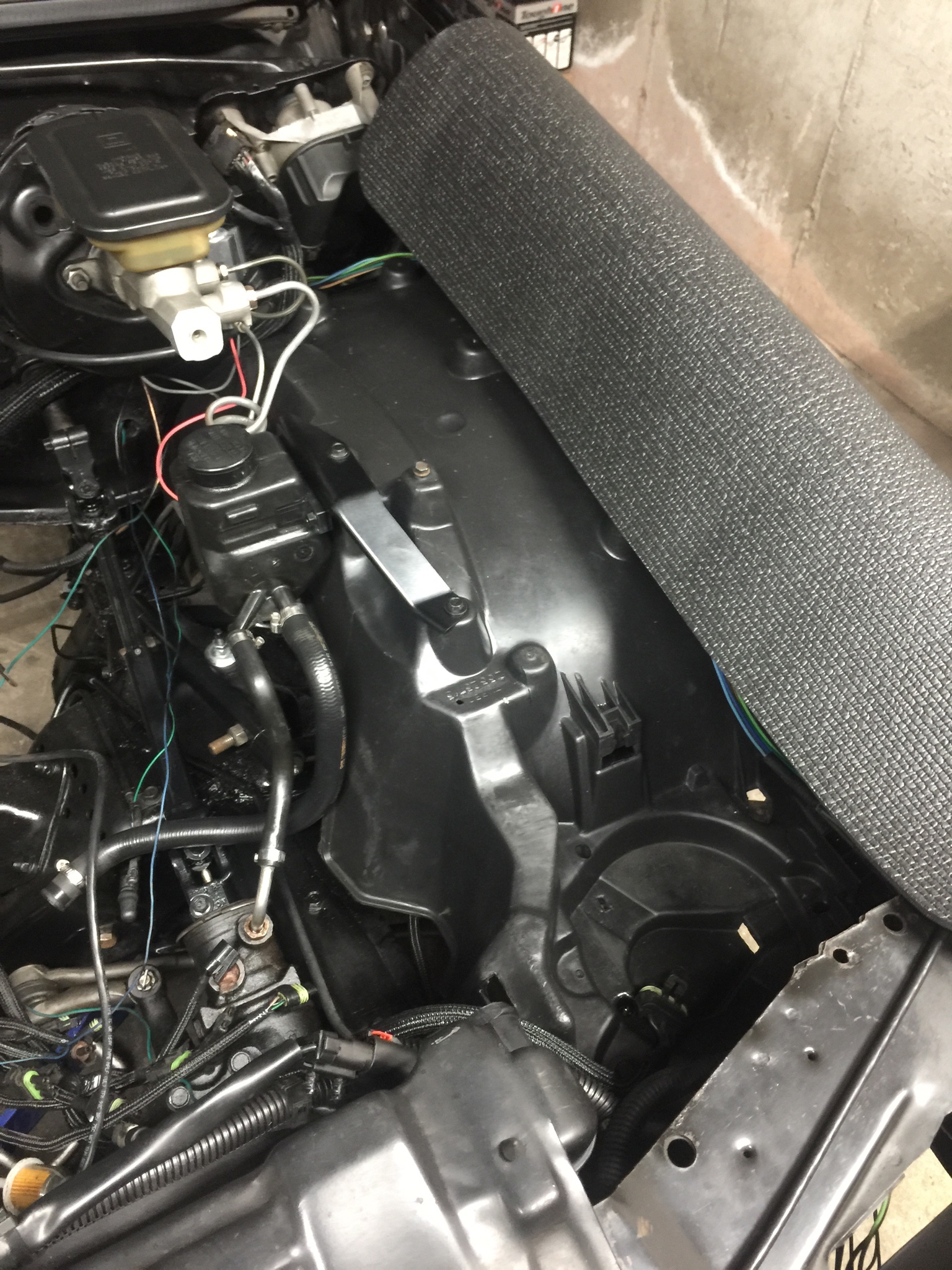

FWIW I just did kirbans shaft upgrade and im very pleased with it. No slop in the joints and took less than an hour to swap out. Lots of room now too
