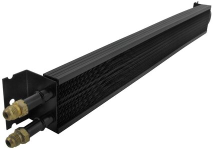

I ended up installing a De Rale frame mount cooler on lower edge of rad support to help lower the temps.
I also changed my PS fluid to a synthetic fluid made by Sweet Mfg which will withstand higher temps .
It’s much better now.
As I recall think my fluid temps were running close to 200deg F prior to these changes
Here’s a pic , I used AN fittings & push lok hose

Is that the 24" cooler? On the 2 test runs I did after i installed the HB set-up (10 & 20 miles) I was seeing about 180°F, 90°+ day with a/c on but I thought that was to high. The cooler I just installed is only about 12" also mounted at bottom of rad support, find out tomorrow how much it helps. Don't understand why the temps are so high.
No , not 24” model, I don’t recall but think it’s about 17” long.

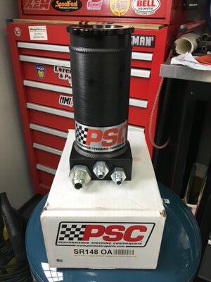

I also installed a PSC (Power Steering Components) PS reservoir made for HydroBoost which has an internal filter & also increased fluid capacity & reduces cavitation dramatically .
Both these help to reduce the fluid temperature .
Here is the PSC PS reservoir with AN fittings

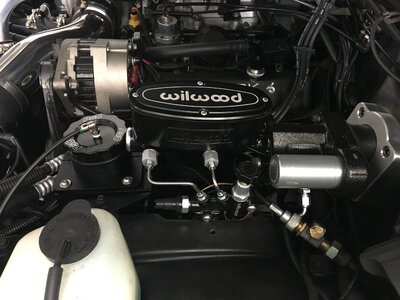

Here’s the valve I am talking about , I have one set up in my HB system.
Yes, you need to remove the factories stock proportioning valve if you’re gonna run the Wilwood one, you cannot have 2 proportioning valves installed
You’ll have to do some brake line plumbing to do this .
