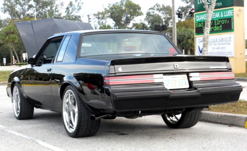

Well, I have 20 X 10s with a 5.25" back space and had to use a .40" spacer which gives my tire about a quarter inch of space to the frame. Don't make sense. Why would the BS work differently with an 18" wheel? If my 20s had a 5" backspace, and I didn't use a spacer they would be at full contact with the frame on both the front and rear of the wheel.
I'm thinking of ordering a set of 18s X 9.5 or 10", but I figured 4.75" BS would be the most I could use. When you say you have no problem, how much space do you have between the widest part of your tire and the frame?

Actually, no. The OP was asking about Boss 338 wheels, which, if you google them, you'll see they are Ridler brand wheels. Now, simply because there are different manufacturers of wheels doesn't mean that a 5" backspace for one brand is any different than a 5" backspace for another.
