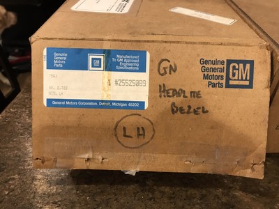

WOW! So GM did mold all black bezels at some point. thanks to Robert for finding the ebay ad above. there is a ton of info to work with from that listing. I've saved all the pics and will upload here.
Ironically, those bezels came from Kirban's per the shipping label. I'll email Dennis to ask when the Grand News & GTO address labels were last used and/or when he moved from that address. I'm familiar with the receiving party. Ron's Custom Auto's at one point shared a building with Jack Merkel Performance Engines. A multi-part series of articles re: Buick V6 began in May 2002 in GM High-Tech Performance magazine highlighting these two shops at that address.
We can see the blue & white GM parts label is the old version. One box did not even use a label. the 75A3 and 75B3 are date codes, i just have to remember the cipher. I thought A and B would be January and February while the 3 would be 1993?
Today, GM parts labels use the YYDDD format - YY is last two digits of year while DDD is 001 to 366 day of that year.
here are those pics from the ebay ad above. Maybe the seller will share when he came into possession of these bezels?

from me? thought this topic was completed. we both have some all black bezels that are in fact GM parts made from at least the early 1990s to possibly the early 2000s. When GM moved production to Canada for these bezels, they came molded in grey ABS again and painted black.
address label info could have been accurate up to the mid-2000s per Dennis K - so that is not much help. date code on the boxes from ebay listings yielded more info...
Investment molds are only good for a certain number of parts before the mold wears out and will no longer product first quality parts. The all black bezels have a lot of mold tooling marks around the part numbers just like the Made in Canada versions. The ebay listing you found for the all black bezels completes the research for me. those were made in 1993 from what I conclude.
