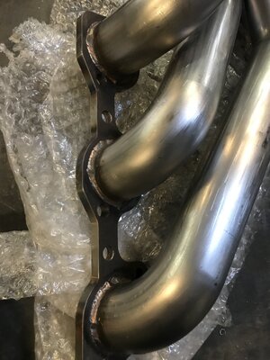

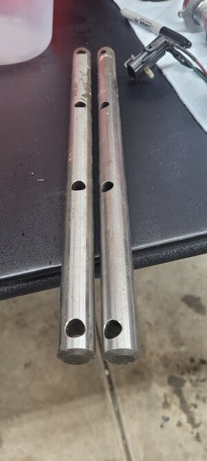

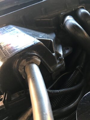

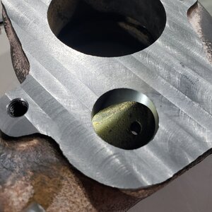

This is part of my current build, still need to update it and add to my dig.. I think one major improvement could be the cam,
