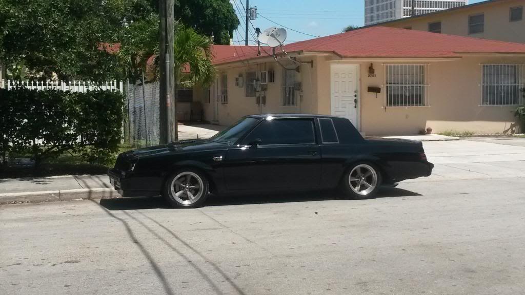

Your chassis set up and springs, and the car being lowered are all factors in killing traction especially at the track.
A stock GN suspension set up will launch better than what you have, as I have seen many local guys with dropped spindles or springs get their ass kicked off the line by stock suspension GN's with less HP!

I meant a 15" (275/60/15) not 17", sorry. With it lowered, the options for taller tires are restricted. If he can't work the tire then he might have go back to the 17s and go for a different rear end ratio.
You think those monsters will fit he he (; working on testing some 15 w 28inch tire . I wish mt made some additional sizes in 17 inch rims
