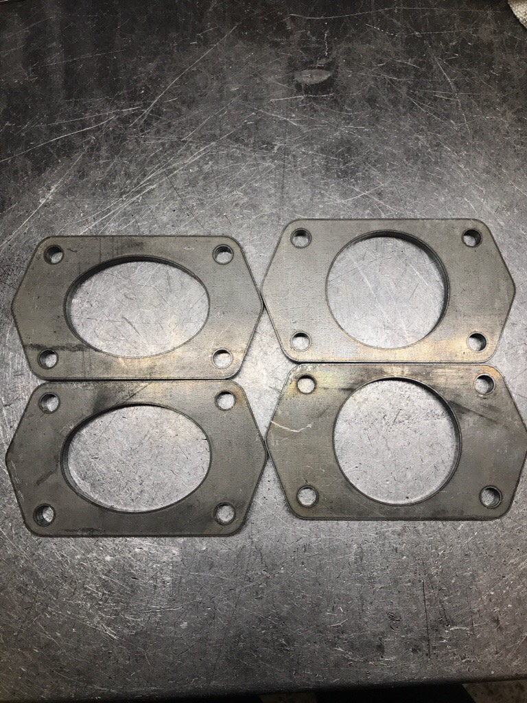

I've got these in 316 stainless. What you do is get a proper length section of 3" pipe and squeeze it down in a vise to match the flange on one end and get another 3 bolt flange and then weld both flanges on after mocking up for proper clicking
