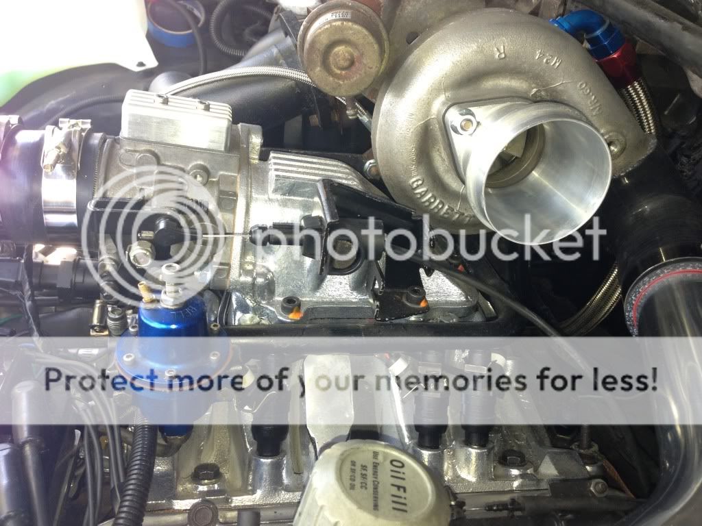

I am working on this set-up myself, my turbo out for repair so I can only post pictures of the line mocked up. I am still playing with it trying to get the correct angle, I borrowed some more fittings from a friend to help me see which angle is best. I will post more picture when it is complete with the turbo
I attached a -10AN fitting to the highest part of the oil pan just in front of the starter.
http://s1323.photobucket.com/user/Ignacio_GN/media/null_zps9a5408c5.jpg.html?sort=3&o=13
The top has a oil return line -10AN fitting
http://i1323.photobucket.com/albums/u589/Ignacio_GN/null_zps5095aef9.jpg
Just thought this might help some.
