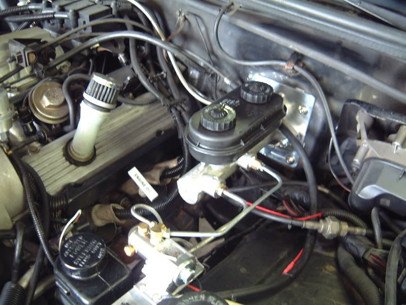

Thanks...The complete rearend weighed in at around 165 lbs. I decided not to notch the frame rails, for now anyway. I wanted to fit a 325/50/15 inside the wheelwell, but I couldn't get the section width inside the wheelwell lip and lower the car. I haven't had the car out yet, I ran into a problem the Powermaster brake system when we started bleeding the brakes. I'm converting over to a Wilwood Manual Master Cylinder, I just got the Firewall Adapter yesterday to start putting everything back together. I'll post some progress pics in the the next few days...John

We got the brakes buttoned up...The Manual Brakes feel really nice. They take a little pressure with the pedal but stop the car good. The firewall adapter worked out really nice and the brakes bleed out pretty easy. The Line-Loc was a nice addition to the car also...

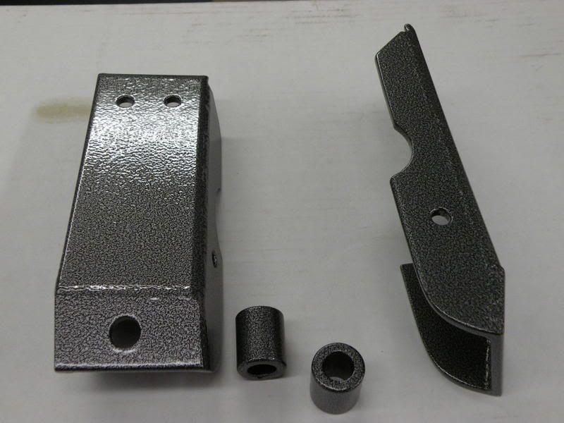

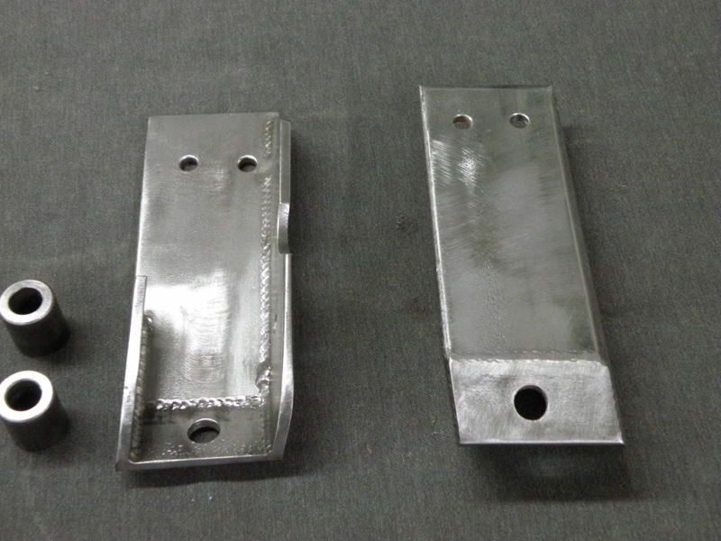

With the rear coil spring pigtails cut off to lower the car, I had a few problems to correct. The first problem to address was the limit of shock travel. I fabricated some new brackets that fit inside the stock mounts, these will lower the lower shock mounting location to increase shock travel.
Shock mounted in stock location...
Shock travel was about 1" in stock location...
Fabricated Brackets...
Powdercoated Brackets...
Bracket installed, Shock mounted in new location...
Travel was increased to about 3" with new brackets...
Second problem was to keep coil springs centered and from falling out when jacking the car up and rear end sags. I fabricated 5" round aluminum tubes that are about 4" tall. The tops of tubes were cut out and mounted where the pigtails were located...

That's an awesome upgrade !! Nice stance. When you went to the manual brakes, did you leave the prop. valve and just plumb in the new MC ?
jevans
Thanks, I appreciate it...I just switched the MC's, stock proportioning valve remains untouched. I haven't had any issuses with the brakes so far.
