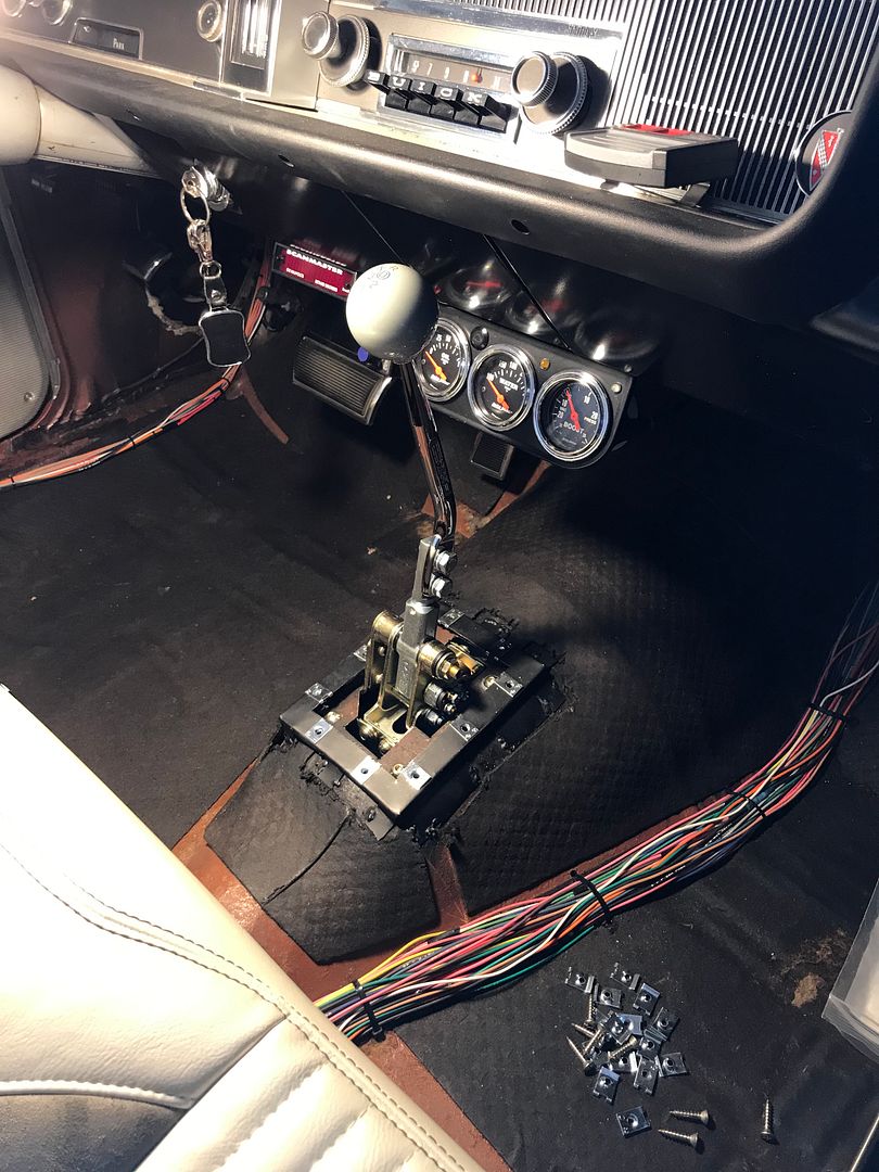

First, I added a floor shifter. Although I like the stock column shifter, it wouldn't engage any gear past "drive". I have a couple extra gears than that, having added the TH2004R. Plus, if I ever wanted to dyno this thing, I needed to be able to shift (and hold) low gear. The shifter is a Summit unit that looks a lot like a Lokar, but with a less elegant park lock gate. The boot is a Lokar unit that I dyed to match the door cards.

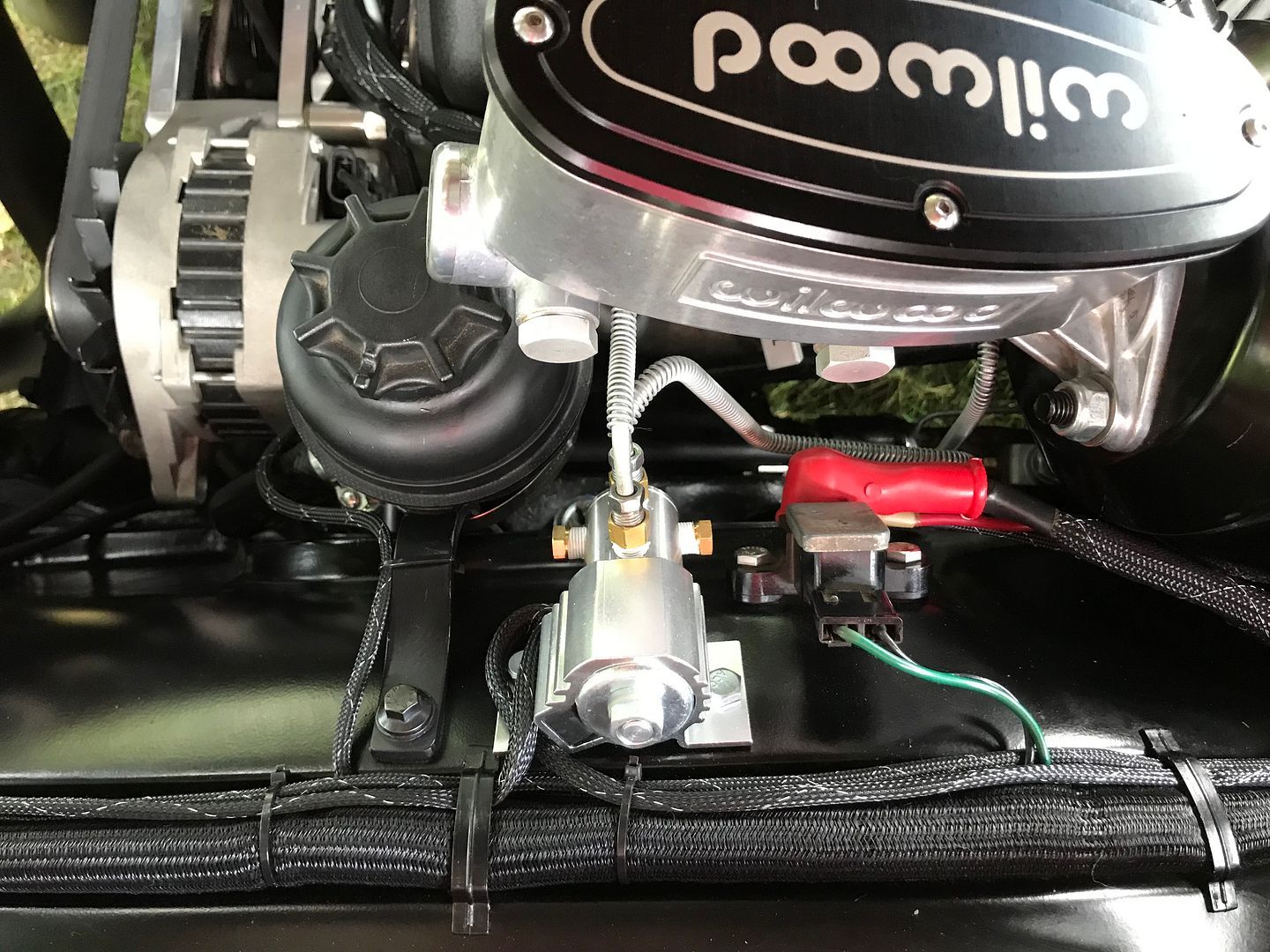

However, I will still do some small tweaks here and there. Such as, I added a line lock over the past couple of weeks. Gotta be able to heat those tires in the event I ever want to go racing!
