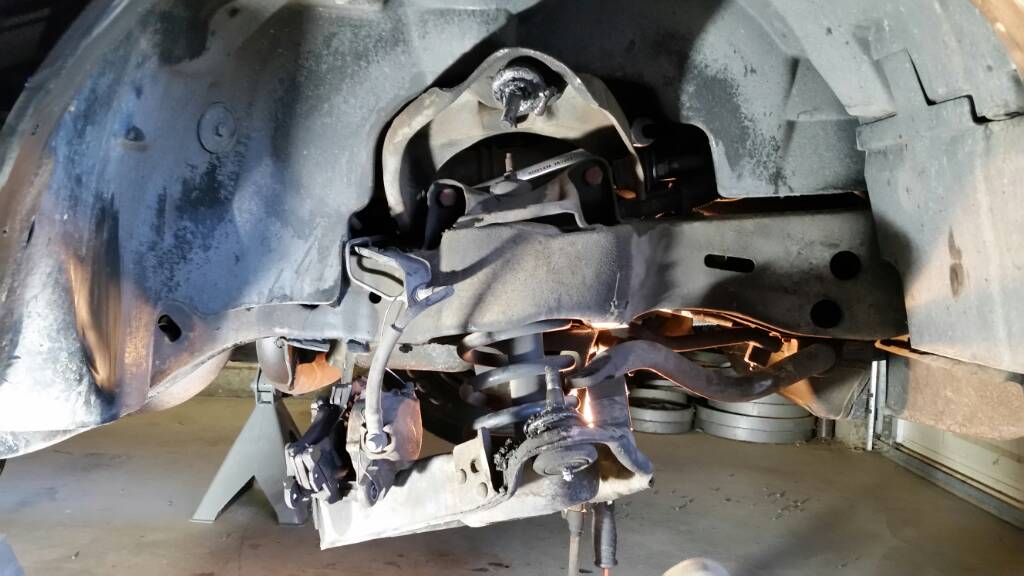

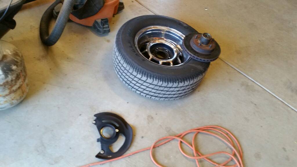

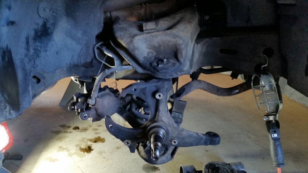

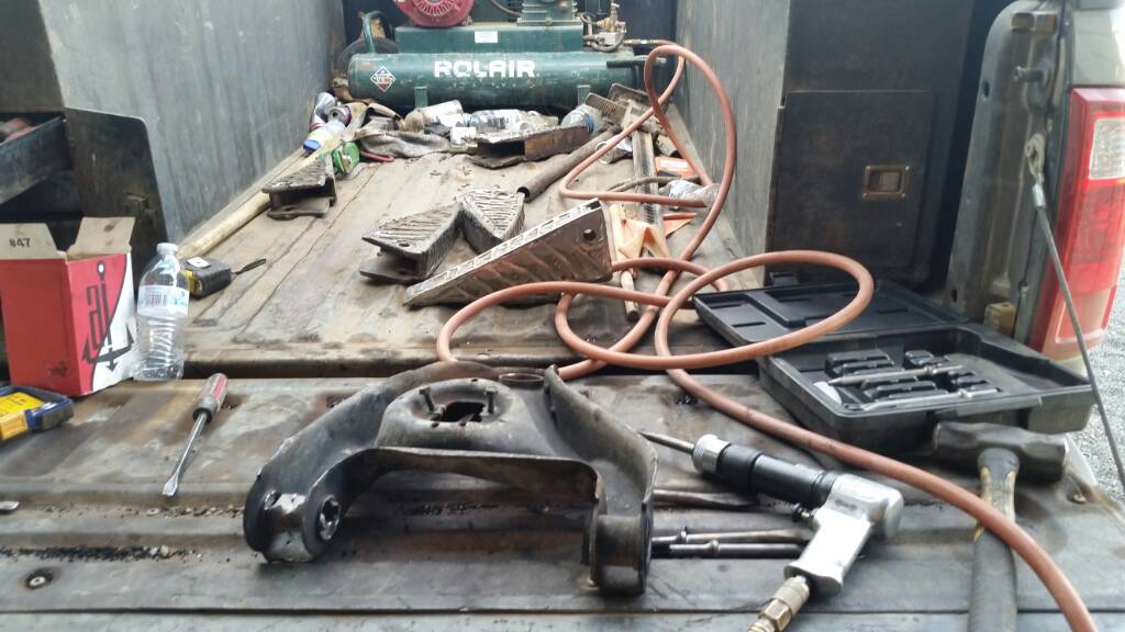

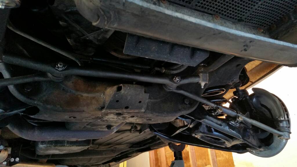

This is what I started with, worn out bushings and alot of grime.

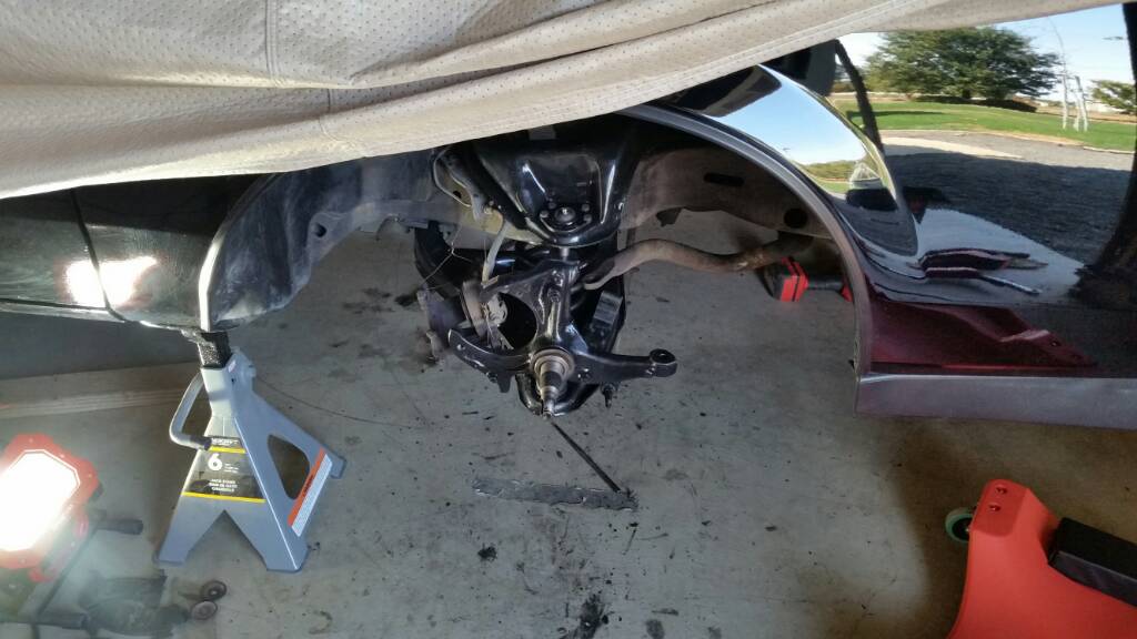

I disassembled the control arms by putting the jack and a 2x4 underneath the rear of the control arms and took the bolts out. Came apart easily and is way better than trying to screw with one of those compressors. I leave the spindle connected but loose but didn't get a picture.

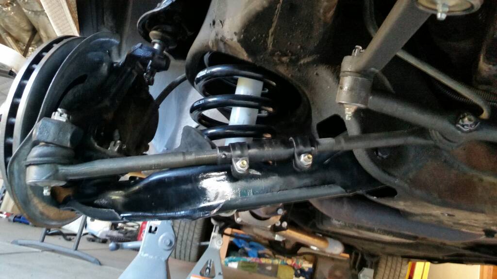

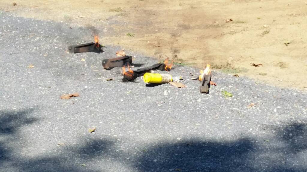

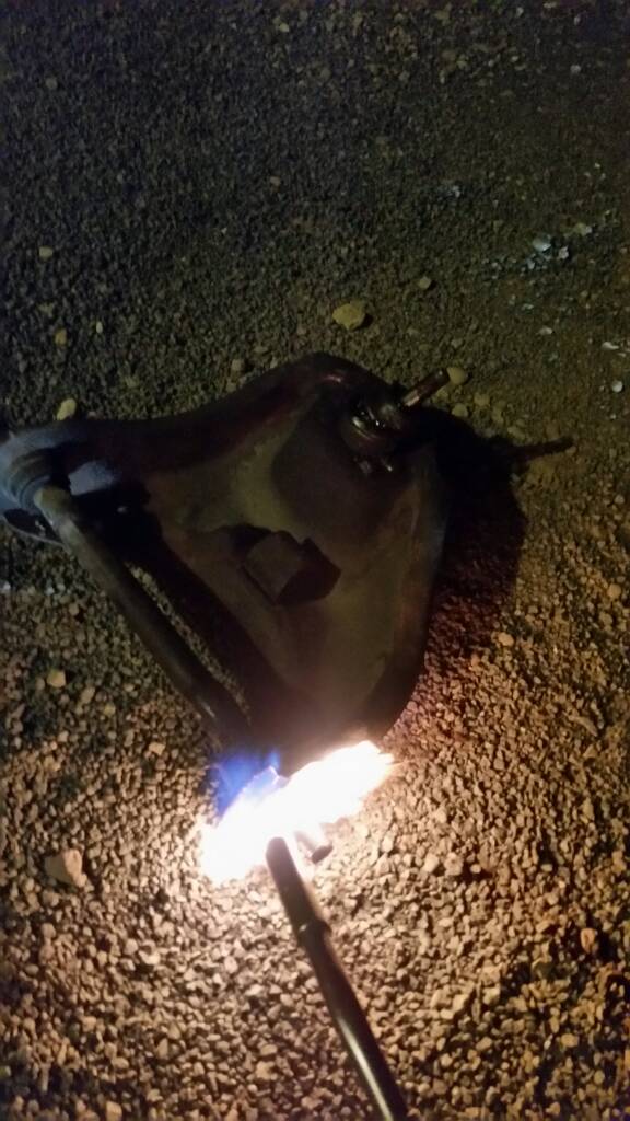

Once apart, I took a torch to the bushings and burned out all the rubber then used a air hammer to knock out the metal.

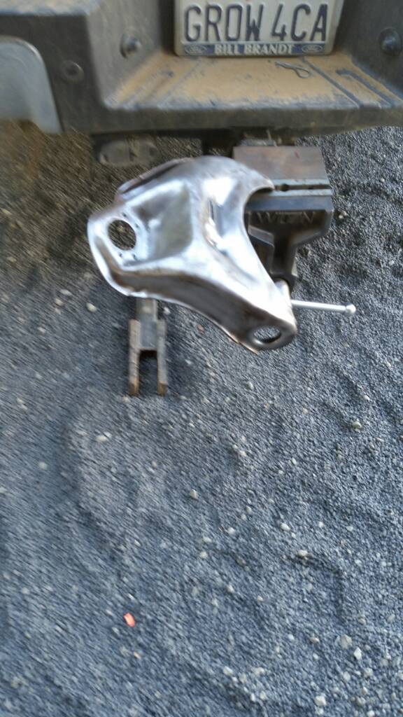

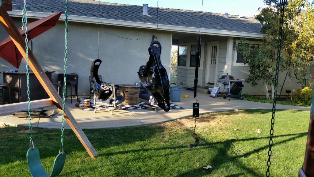

Hit them with a wire brush then painted them black

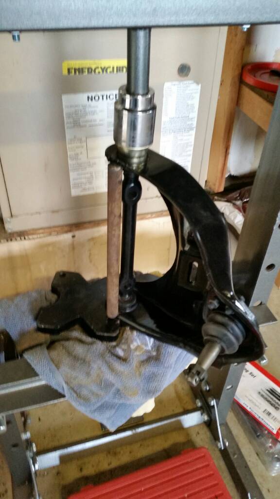

Then I went and bought a $100 harbor freight press to press all the bushings and ball joints back in.

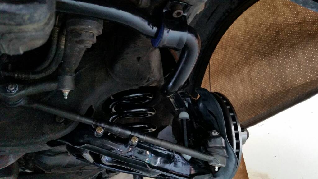

Put it all back together and it looks good

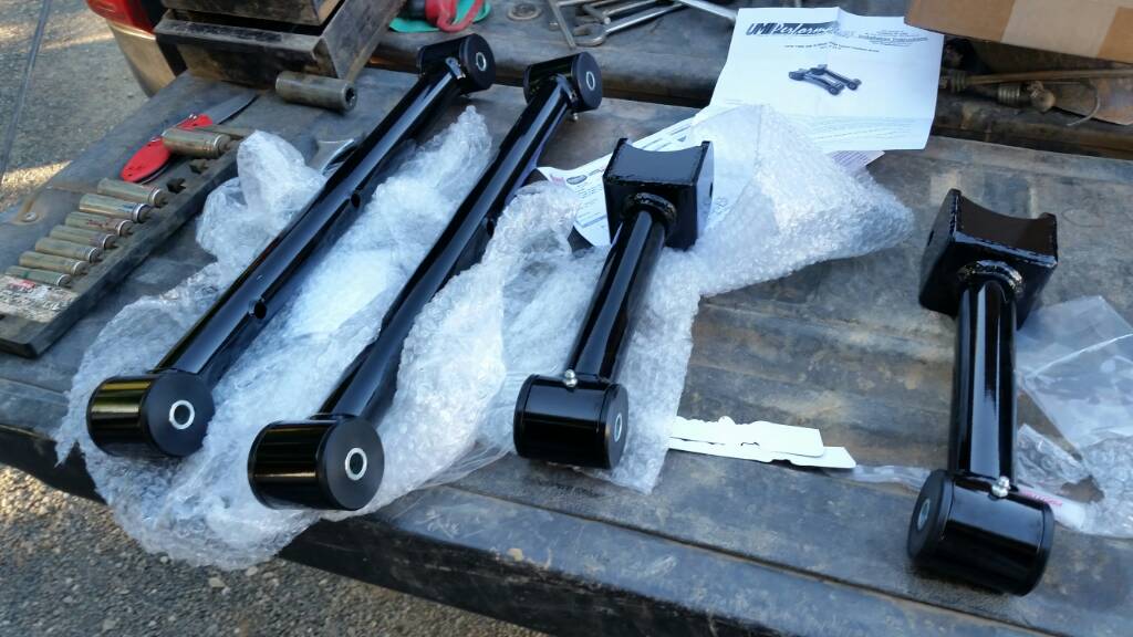

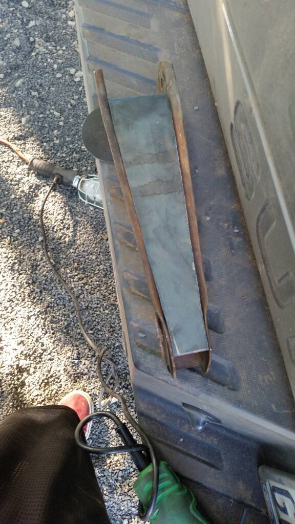

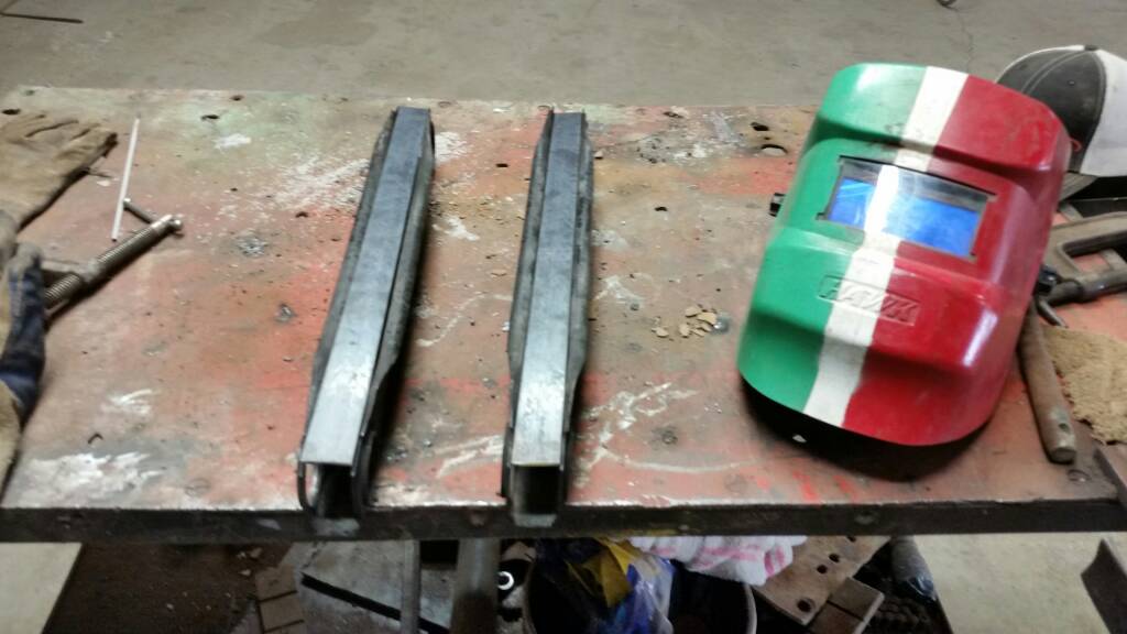

The rear suspension I boxed and painted but was having trouble pressing in the new bushings and in my frustration I just order umi's
