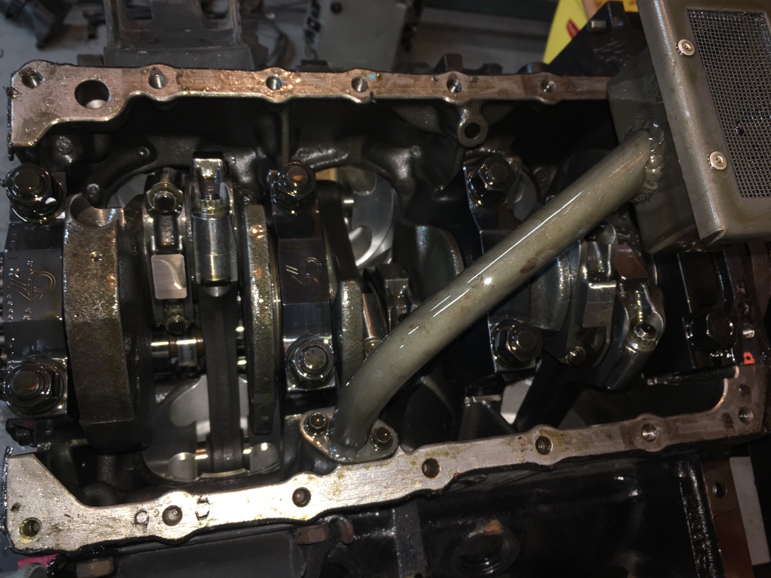

If an engine has billet main caps with studs is the torque value different?
I need to replace the rear main seal on this engine and it has a billet rear main cap.
Engine builder is unknown so I can't ask what torque was used during the line bore process. What do you guys think?

ARP specs call for 110 ft. lbs. using their Ultra Torque lube and 95 ft. lbs. with their no longer available moly lube, or 130 ft. lbs. with 30 wt motor oil. Kind of hard to tell what was used originally. Removing the crank to check the main bores at different torque settings would be the correct way. 120 would be a good compromise if you are not measuring the bores since it looks like motor oil on the nuts and washers in the photo.

Before I removed the nuts I marked them with a paint pen and in increments of 5 ft/lbs tightened them. First movement was 110 on my torque wrench.
Amazingly enough the threads under the nuts and contact areas of the washer still had whatever grey lube was used.
Right or wrong this is why I chose 105.
