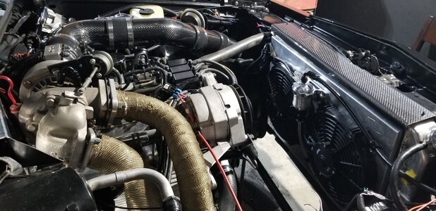

I'll post a couple more pictures if it helps. NOTHING ever fits good in these things so I just accepted that, plus I'm working on a hot air car so I have to adapt everything. However that being said the Cold case rad fit very easy for me. Cut the tab off on the rad support and it dropped right in. the toughest thing was the fittings on the late model turbo regal have the fittings on the front side of the rad where as the earlier models it was on the back. So I had to change over to late model hook ups. the brass was the only thing that fit the gap between the rad and the condenser. Performance world makes a fitting to adapt from inverted flare to AN/JIC which made it a lot easier.

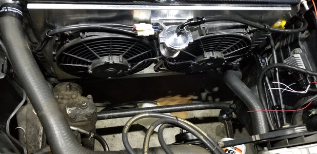

I also have a Janis Stg2 trans, Hayden cooler and Magnafine billet filter housing, magnet and filter, with PTFE lines which are thicker. I got it all to fit, function and look excellent.
Also I would suggest the Gates shrink style clamps. they spread the pressure nicely and don't look ugly. buy two extra when you do so if you ever had to cut them off you have two handy.

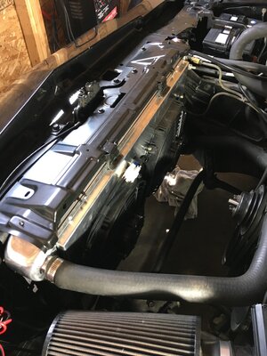

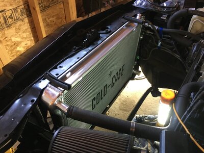

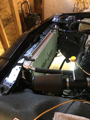

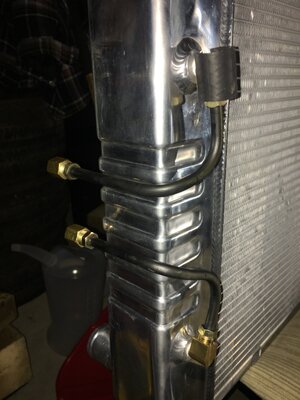

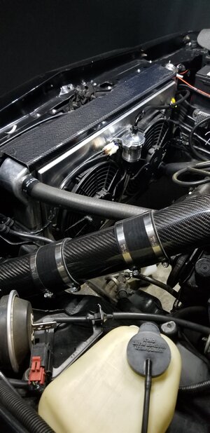

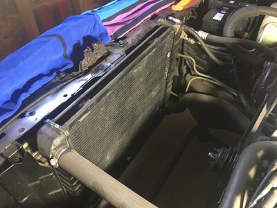

I can post up a couple pictures if you want. All I can say is I found it easy to install. I'd have to search for the pictures, I'm pretty sure I documented the whole thing.

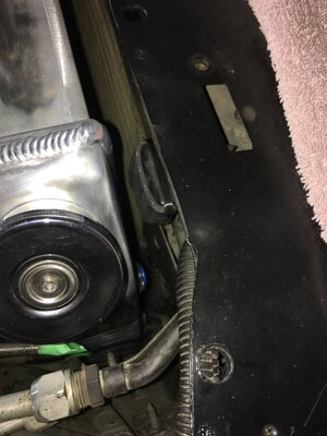

I made sure to put rubber in places where metal could possibly rub. I bent some tube to fit to the existing 84 style lines. which you won't have to do if you have a late model. I removed a couple pieces that were not really doing anything.
Here's an update. I jiggled the radiator, picked it up and put it back down. For some reason I was able to bolt down the top plate now. The radiator doesn't fit flush to the top plate like the stock one but it works. The top plate meets the radiator, if that makes sense. The fans still don't have room to slip into the bottom support , but I think I can make a bracket to deal with that.

Make sure you freshen up the rubbers under the rad. Anything rubber will work, old hose, floor mats, whatever. As long as metal to metal is mitigated.
