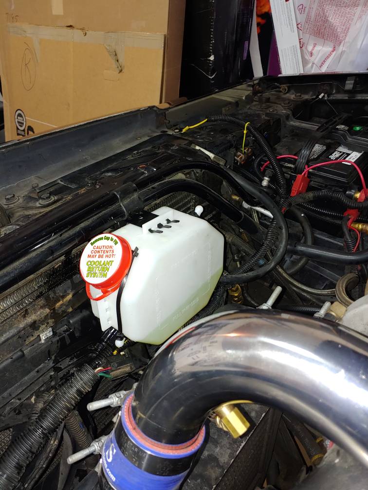

Hi guys
My alt control coolant tank cap cranes and did not fit great anyway.
I found an alternate tan at autozone.
Fits good and has a bracket.
I just bentvtge bracket at 90 and attached to existing bolt for AC line.
Sent from my LM-V405 using Tapatalk
pacecarta
LOGGED OUT
Staff member
Aug 1, 2003
fyi if you are using a stock location reservior alky tank (which it looks like from pic ) ...your alky nozzle is too low and the tank will seek level which is the level of the nozzle ..you could add a tight sealing cracking valve and it would be okay to have nozzle lower than tank fluid level
