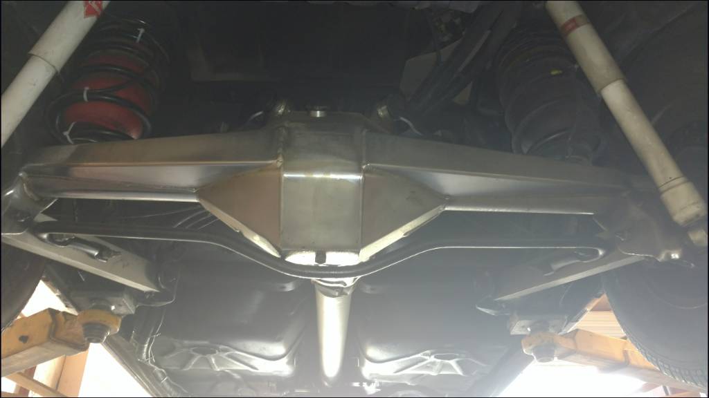

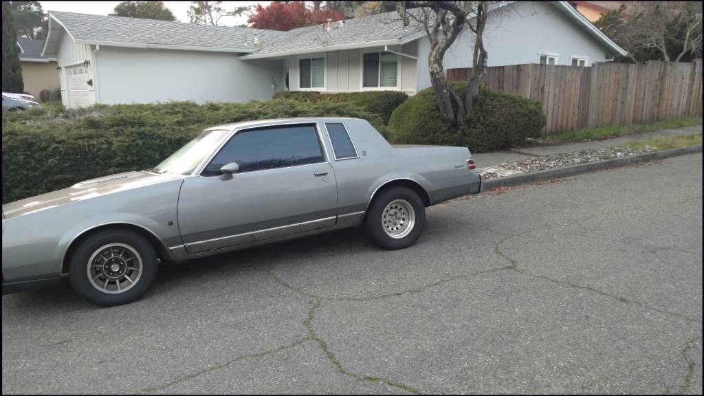

Can't do it, unless you hog em out a bit. I didn't want to drill out and damage original wheels, so this is the reason why I have mismatched wheels. I purchased a Chris Alston's Chassisworks Fab 9 and intended to run my stock T wheels, but was unable to without what's mentioned above. Thankfully, my friend gave me a set of wheels he had just lying around.
