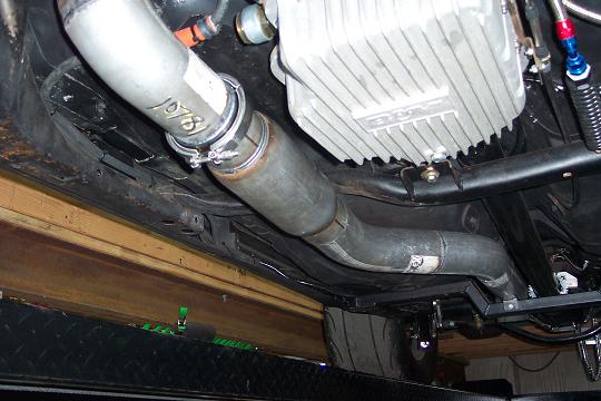

Jack cotton makes them,everybody knows that he's the man!:cool: 3.5dp-4in all the way exit's in stock location.
Welcome To CottonsPerformance.com!
Your gonna find out quickly that everybody's an expert here for every one person who knows what up there are 50 who don't know SH@%*T!!
Call Jack he's one of those experts!
BlackMetal
LoL Jack Cotton "makes" them, anyone can go to Summit and order the different pre-made mandrel bends and joint clamps like in that picture. That's what I'm eventually going to do since I haven't found someone to make it. In terms of a true mandrel bent exhaust larger than 3" it still doesn't exist for our cars, and mainly because most mandrel machinery just isn't set up for piping that large.

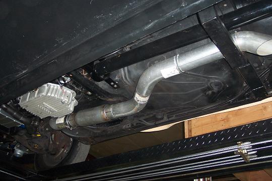

I have 4" mandrel bent from the 3.5" DP back . GUy who did mine could mandrel bend all the way up to 6". Wasn't cheap but it can be done!

RUQWKNF27
Since this pic I have changed the DP onthe car and the part where it necks down @ DP is gone. Now has a 3.5 to 4" reducer with a v-band clamp!
