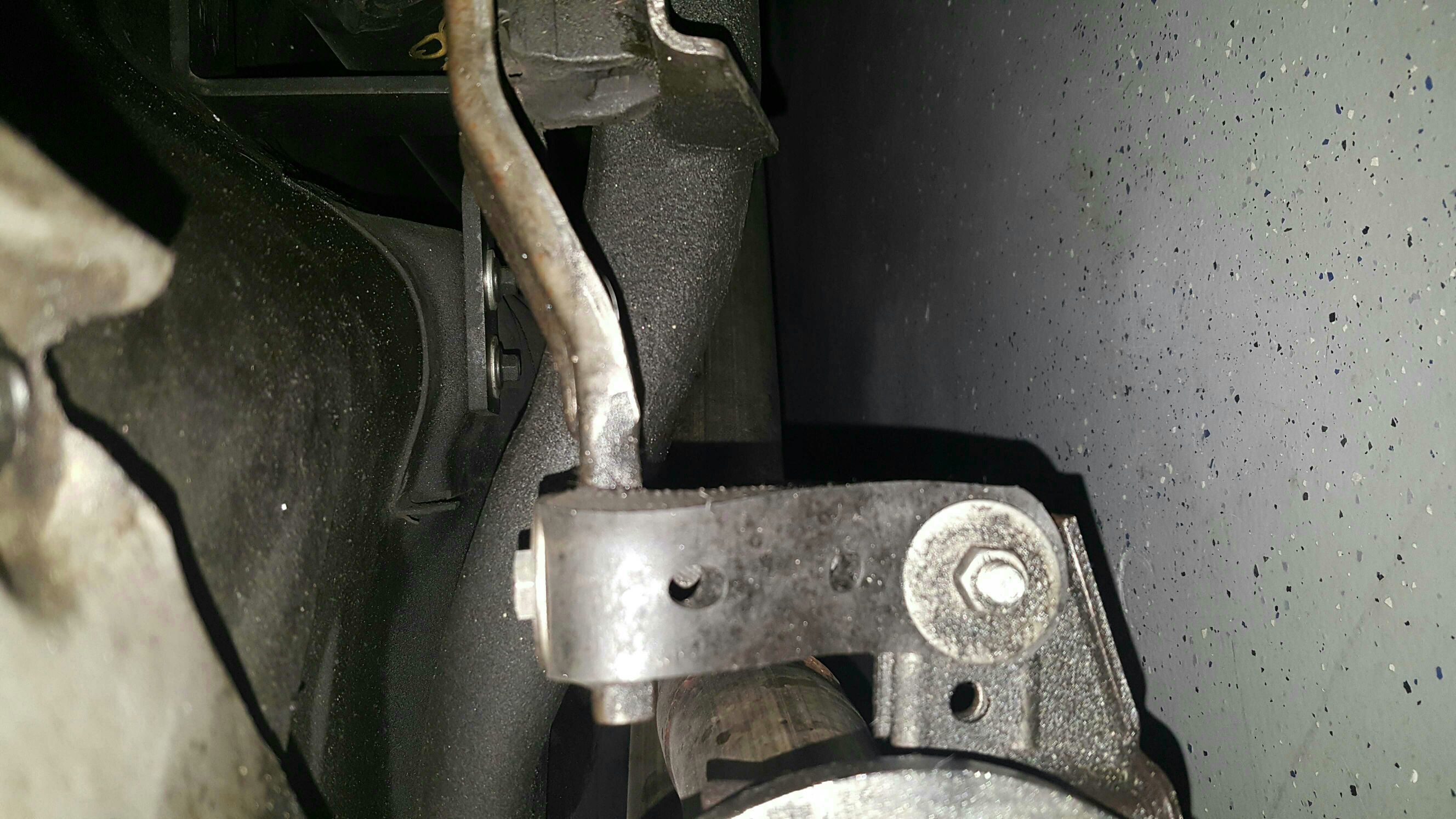

I drilled out the rivets and cut a rectangular section out of a old garden tractor tire to use as the rubber replacement. Car tire might work but most have steel belts and I thought that would make it much harder to cut. Maybe a conveyor belt or some kind of mud flap could also be used.
Cheap exhaust hanger from Advanced Auto.
Sent from my SAMSUNG-SM-G920A using Tapatalk

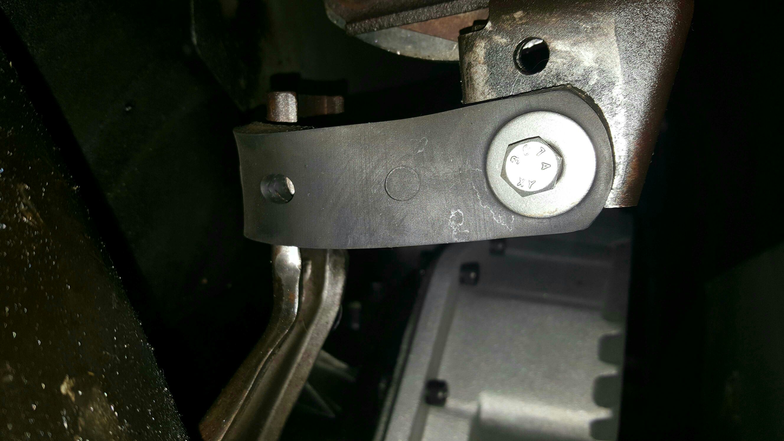

Front view, did a few years ago with SS bolts.
