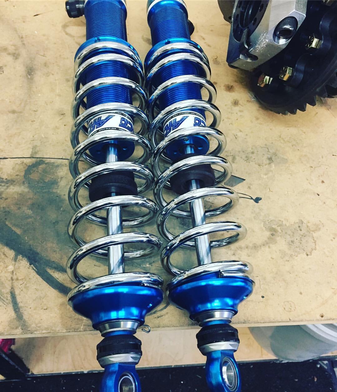

Sold the 10 bolt and spec'd this TRZ 9 inch for the car. Ordered it with no spring perches, and coilover brackets installed as well as anti roll bar tabs for the TRZ anti roll bar I'm going to use.
Also got a AAPerformance tubular torque box with several adjustment points, plan is to cut out everything in the frame and start over.
Bought coil over conversion parts for the Afco shocks I had.

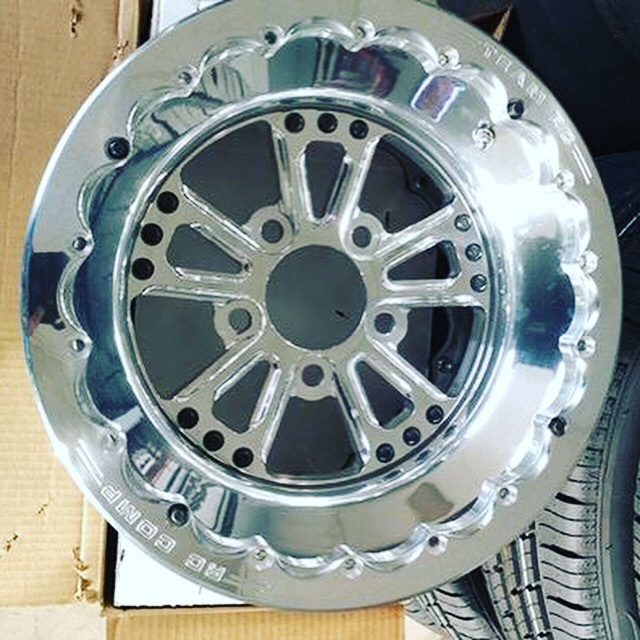

RC Comp double beadlocks. Twisted 6 racing are dealers for them now.
