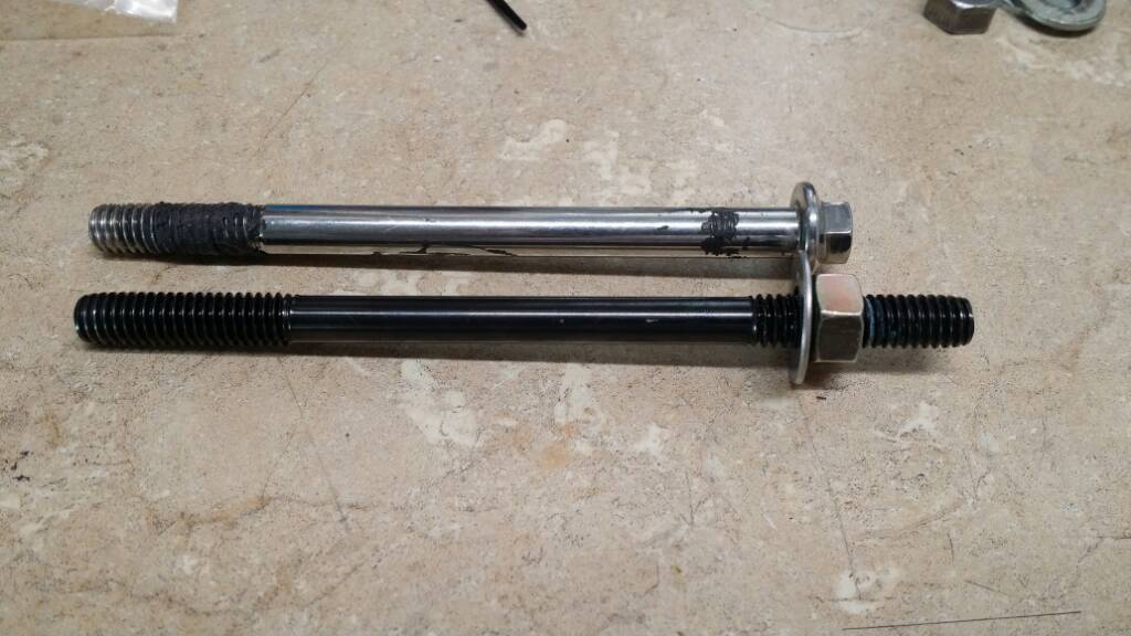

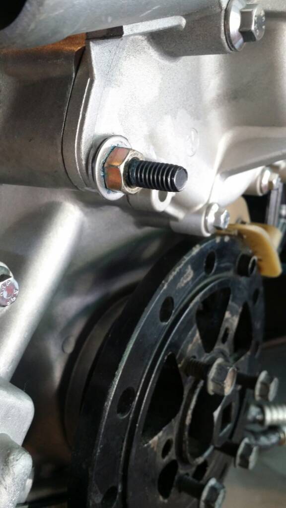

Ended up going with a stud. I bought a 5" and made it work by shaving a washers width off the water pump boss. I'd go with a 6" the next time I'm jacking with it.
