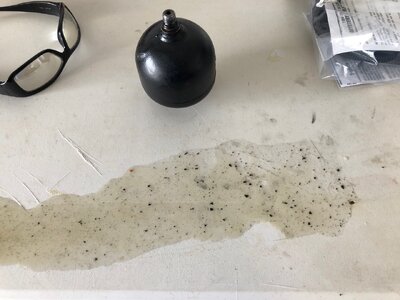

I did notice the fluid that came out of the old accumulator had black flakes in it that disintegrated when I touched them, really weird. Photo is attached. I did not see any of the black flakes in the reservoir. I'm going to change the fluid tomorrow. and see how that goes.
