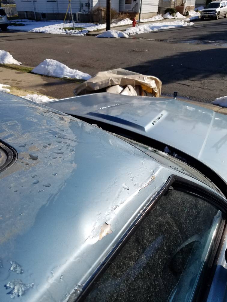

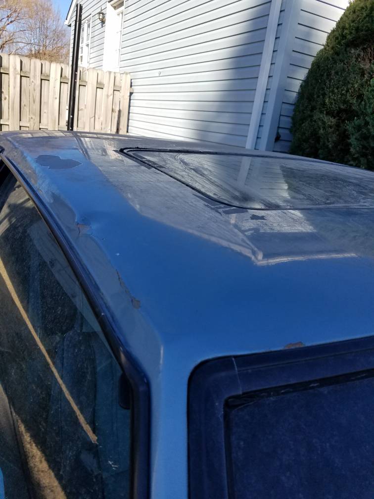

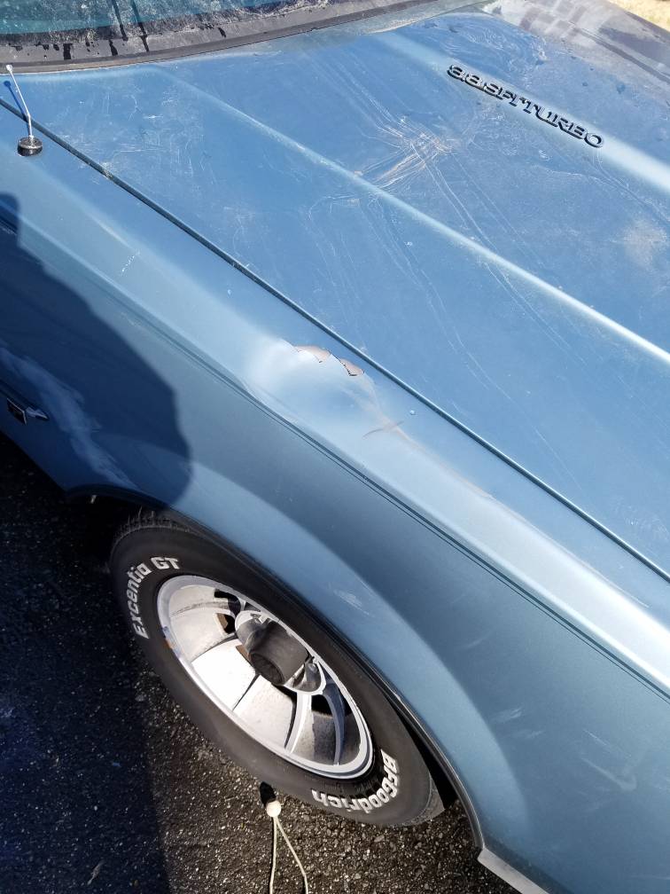

We recently had a snowstorm and I had my t parked under a metal framed tent structure. Well before I had a chance to knock the snow off it collapsed continue car. Left me with a dented up roof and damage to the fender and grill. Grill and fender I know are easy enough to repair/replace but I'm very concerned about the roof. Here are some pictures let me know if this is something that us repairable please..

It can be repaired. Pull out the moon roof, mouldings around windshield, black trim around door glass. I would also remove rear glass trim, side glass, taillights, rear bumper and fillers. There is no good place to stop when refinishing the roof so I would blend into the quarters . The damage I would pull out, then finish with filler, prime and block out then refinish.

Sorry for your luck. Anything is repairable if you want to spend the money. :(

Sounds like allot of time and money and I don't know anything about bodywork to do it myself. At this point I think I'm going to just have to sell her for whatever I can get.

Sell it? Does it not run any more? Sounds like a good time to hit YouTube and learn about body work.
I've seen way worse and a good body man(or woman if you can find one) can fix just about anything. The break come when the estimate out does the attachment to the vehicle.
I'd drive it like that and do the body work as you can. Especially if it is a cf5 moonroof car. And baby blue, you don't see that every day. They'd be burying me with it.
I wouldn't sell my car for a few dents. No way. That right there would be my excuse for a new complete paint job. I would check with the homeowners insurance also.
