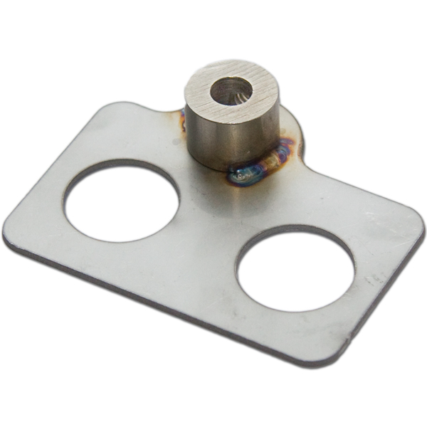

    Billet CNC Pump Couplers in stock
    Billet CNC Pump Couplers in stock:
    [IMG]
    Discounted price when bundled with our Double Pump Kit:
    [IMG]
