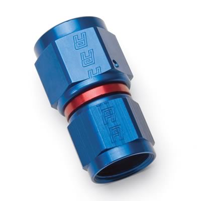

And here's how.
3/8" NPT to -10 fittings out of the sump, -10 lines into y-block, -12 out of block into the filter, -12 out of filter into pump.
I would use NOS part # 17847 (Red for fuel)
Out of the Y block into this Russel #640570
This Russel fitting will attach to an Aeromotive part #15612
The Aeromotive fitting will screw into either the prefilter (if you run one) or into the Eliminator pump. O-ring cut off end into the filter or pump.
And go from there.
Short of welding a -12 steel weld bung to your sump, this would be the easiest way to plumb the dual line setup.
Hope this helps.

Wow!! Thanks for the informative reply Patrick. I just got off the phone w/ Brad, the tech at Aeromotive and suggests to do the exactly the same. You're the man Patrick!!!
